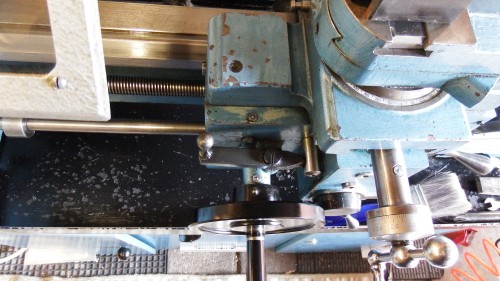

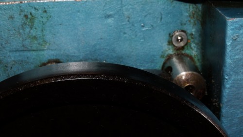

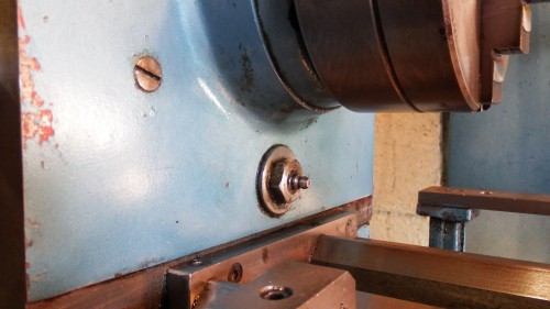

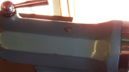

These are the oiling points and grease points I have found. Please let me know if I have missed any, many thanks Alan.
2 points at end of leadscrew and backgear
1 on top of tailstock
1 on counter
1 oil filer on saddle

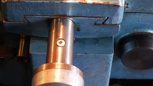

2 points on cross slide handles
1 point on back of saddle
2 points on saddle
1 point on big handle on saddle

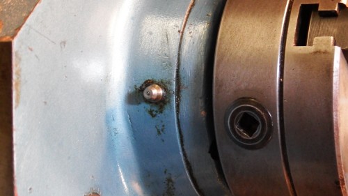

1 grease point at side of chuck
1 grease point under chuck
2 points on top of casing over headstock
1 grease point inside gearwheel cover

I think there should be an oil filler point somewhere on the gearbox casing, at least there is on the slightly bigger Synchro with a similar looking gearbox. Its probably got a hex head and is near the top of the right hand end of the gearbox, with a similar one near the bottom for draining the oil. I think there should be a round viewing 'window' as well. Although there is a lubrication point on top of the cross slide, for oiling the feedscrew, which you have found, Denford don't seem to have done the same for the topslide feedscrew, so from time to time, wind the topslide back as far as possible, then peer underneath it and squirt some oil on the exposed feedscrew. It doesn't need doing very often as the topslide doesn't get used as far and as often as the cross slide.
ISO 32 hydraulic oil is pretty much the universal machine tool oil these days and should do for all your needs including slideways. From time to time I give the changewheels under the end cover a quick spray with an aerosol can of motorcycle chain grease, it doesn't spin off and cause a mess.

Thanks Richard, I have drained the gearbox oil and replaced with 90/140 synthetic gear oil, using a printer ink syringe, slow job. I have been using bike chain spray oil on gearwheels and agree much better. I have been watching videos by John from Doubleboost (YouTube) which have been very helpful. I keep the bed clean with WD40 then use the spray oil. I also lubricated the leadscrew/backgear and speed selector levers. I wish their was a Haynes type manual for everything, this would make life easier. Especially being a novice, I have also oiled under the cross-slide, put a mark on so as not to run the screw out, thanks again cheers Alan.
