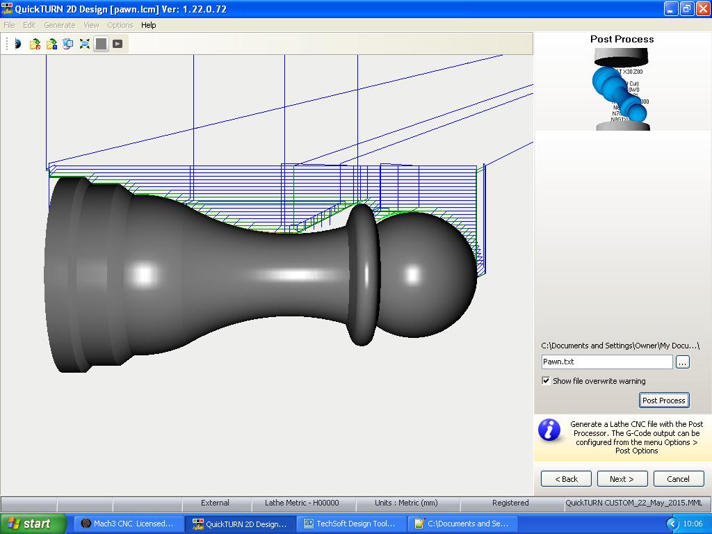

The toolpath seems to miss out on the reverse cuts but the simulation runs fine!
Virtual tool Paths.JPG (94.32 KiB) Viewed 25489 times

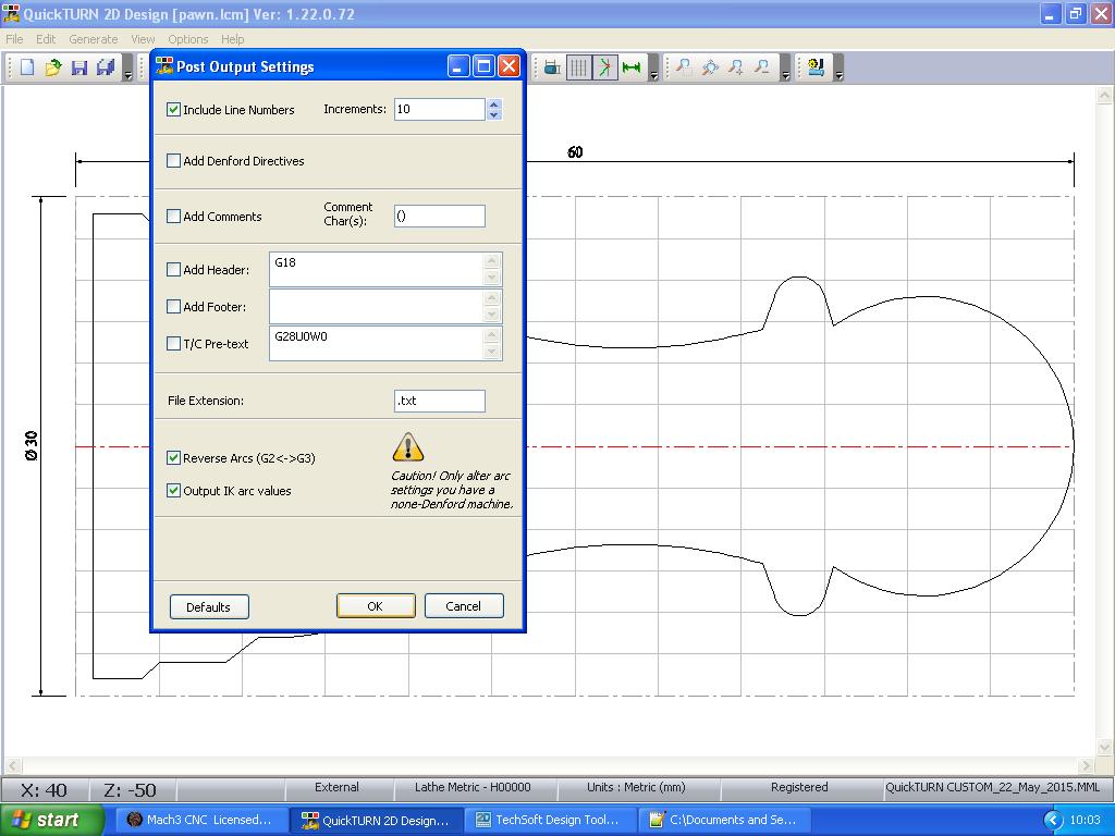

There are several random moves when opened in Mach 3
Mach3 Pawn.JPG (152.64 KiB) Viewed 25489 times
These settings worked the best but still problems
Post output settings.JPG (101.86 KiB) Viewed 25489 times
Re: QuickTURN 2D to Mach3 issues
I would try going into the tooling library and uncheck all the tools that are unessential.
I would then ensure the tool geometry is correct for all the active tools.
I find it difficult to see the unwanted moves in your graphics.
The software is used mainly for training purposes and there are some moves that seem unnecessary but are in the program to ensure material is removed from each at the start and finish of each segment the Cam selects to be machined by each tool.
