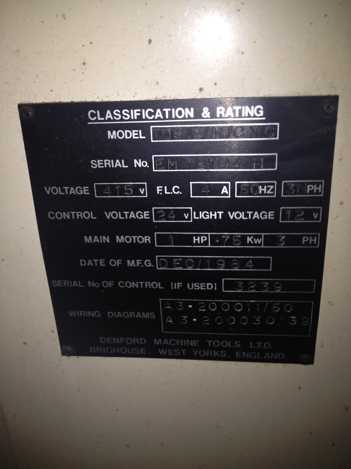

Hello everyone. This is my first post and the first of many questions no doubt after I bought my Denford Easymill 3 last weekend.
The machine is a 3 phase 1984 model with a belt driven spindle driven by a 3 phase motor. If I connect the machine up to an inverter, will it work ok? The coolant pump is also 3 phase.
I ask because I had heard somewhere that cnc circuitry may not function correctly if it isn't fed by a "true 3 phase" supply i.e from an inverter.
The model number is TDS/E/M/CNC,
Serial number is EM12104 H.
Control voltage is 24 volts,
Main motor is 1hp, 0.75 kw, 3 phase.
Wiring diagrams are shown as A3.200011/50 and
A3.200030/39

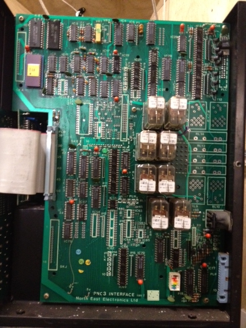

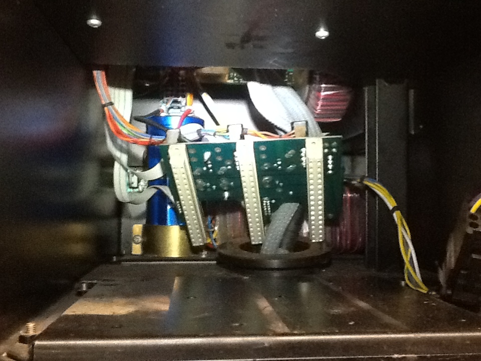

Attached are some photos of the machine with info plates and some of its insides.
Looking inside the control box at the board that the stepper drivers connect to.
Stepper driver connection board.JPG (397.7 KiB) Viewed 43213 times

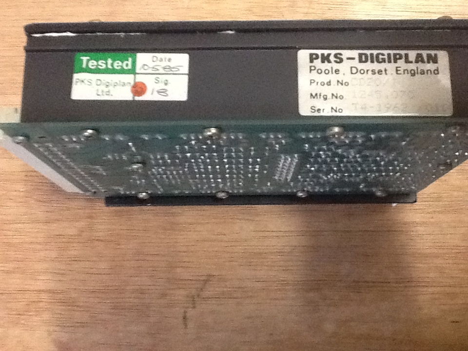

One of the stepper driver boards showing the manufacturers details.
Stepper driver.JPG (451.67 KiB) Viewed 43213 times

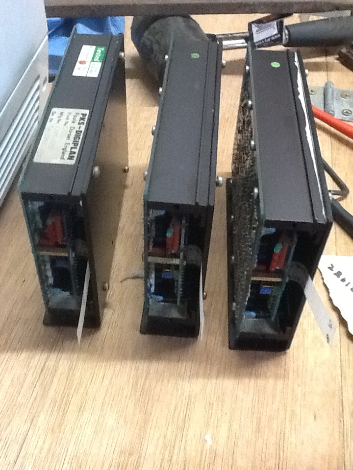

The three stepper driver boards removed from the control box.
3 off stepper drivers.JPG (487.07 KiB) Viewed 43213 times
The North East Electronics Power Distribution board.
NEE Power Distribution board.JPG (428.47 KiB) Viewed 43213 times
The PNC3 board.
The PNC3 board.
PNC3 Board.JPG (241.74 KiB) Viewed 43213 times

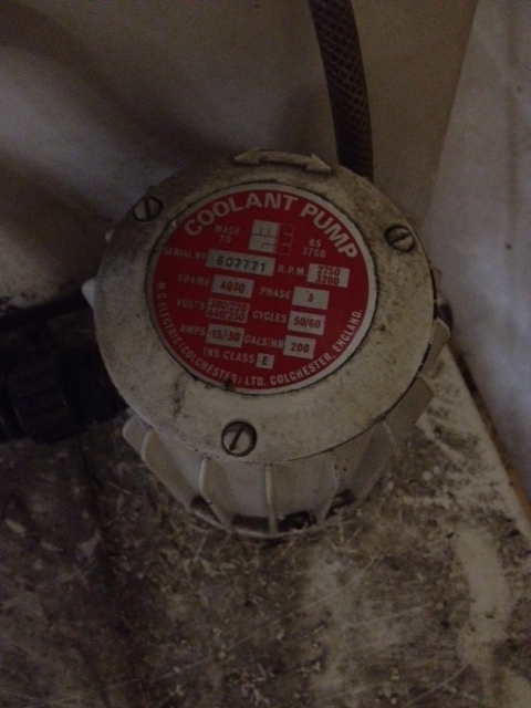

The coolant pump motor plate.
Coolant pump.JPG (162.59 KiB) Viewed 43213 times

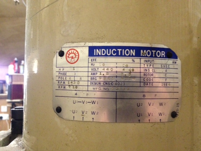

Main spindle motor plate. It looks like its been attacked around the edges with tin snips.
Spindle Motor plate.JPG (183.16 KiB) Viewed 43213 times
Specs plate attached to the side of the machine.

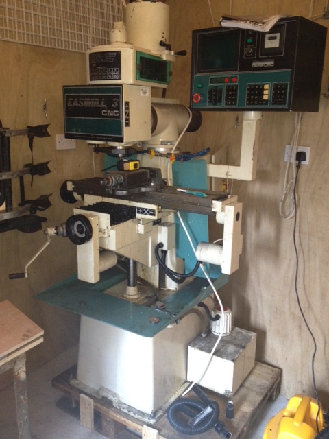

This is my new Easymill 3

I've got the same exact machine, also running Mach3 since the original firmware on the EPROM's deteriorated over time. Denford apparently hasn't saved any of the old firmware?! Had to replace a bunch of perfectly good boards in an almost-new machine. :evil: There is no reason to replace the drives, the original drives and power supply are perfectly fine, I did my conversion about 8 years ago and it's still running very strong. All you really need are a couple of breakout boards and a vfd for the spindle and one for the coolant. The original spindle motor is quite good too, I run mine from 10-180Hz NO problem. Denford really screwed the spindle lube though, they added a tap off the reservior to feed the Z-axis leadscrew. On mine ALL of the spindle oil went to the leadscrew and none to the spindle. Fried two bearings before I figured out what was going on.

You say your machine is the same and you run the spindle motor through an inverter. Is your spindle motor the same as the one in the pictures? I'm trying to work out if the motor on my machine is dual voltage so I can run it from an inverter like yourself. The name plate shows 440 and not 220. If you could confirm this I'd be greatful.
Re: Can I use an inverter with my easymill 3?
My motor looks identical to the one in the photos. Pretty sure that the dataplate on my motor and on the mill are both marked 220v instead of 440v, I'll confirm when I get home tonight.

I've noticed the time of your post, do you work nights or are you based somewhere west of the UK? I'm thinking that if your in the States your supply voltage may be different to ours so the inrternals of motor might be different to suit that voltage. If I understand correctly, 3 phase is 220 volts in the States while it is 440 volts in the UK.
Sorry this is so late, I just checked and yes, both the motor and the mill are marked 220v on my machine. I'm in the US, 3-phase here is available in 220 or 440v, but not in my home shop. My mill gets 240v 1-phase from a dryer circuit, and I've got two VFD's to make it 3-phase, one for the spindle motor and one for the coolant pump. I'm still using the original CD20 stepper drives etc.
