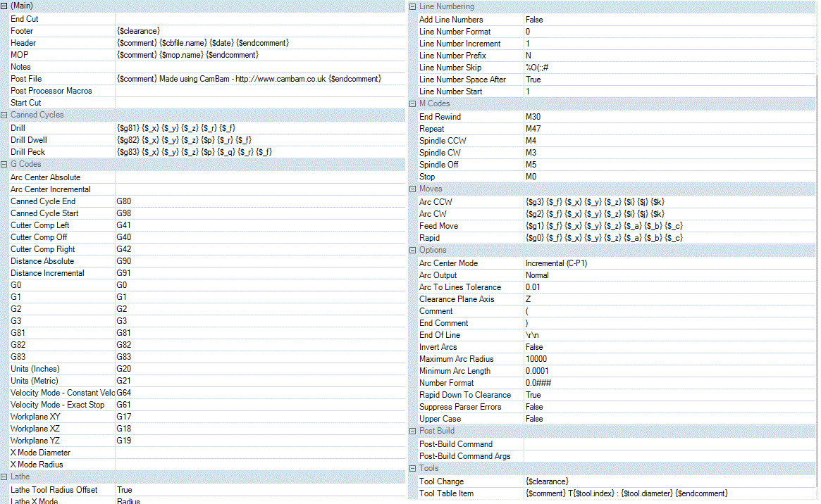

has anyone found the right post processor settings for CAMBAM for a 1999 Novamill running VR turning 2.31 and a Novaturn on DOS?
The options are...

If not does anyone know how to create a config for them...
Having had a better look none of the optional settings use a ";" for comments so I guess I need to make a custom profile... thoughts?

Post processor Settings...
Postprocess 1.gif (95.79 KiB) Viewed 25028 times
