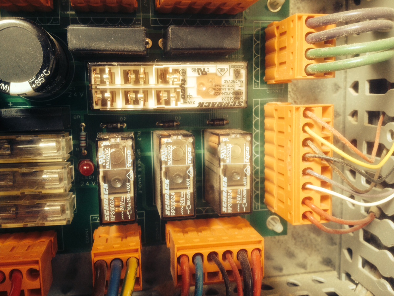

I do have an amber flashing LED on the main board and have noticed that a relay above the three main axis relays
appears to have one of its contacts permanently close even when the machine is powered off.
Has anyone got any ideas?

Relays
Relays
photo 1.JPG (458.38 KiB) Viewed 7372 times

I'm not an expert on CNC electronics, but I do have an electronics background.
With power off all relay armatures should spring back to the released position. It's possible though that a relay could be powered from a charged capacitor, but it should release once the capacitor is discharged.
Depending on whether they are Normally Closed (NC) or Normally Open (NO) types, all relay contacts should revert to the correct state when the relay coil is unpowered.
If an NO contact is in the closed state, then it's possible the contacts have become welded.
An NC contact will be closed when the relay is unpowered, but will break when the relay coil is powered.
It's generally possible to remove the transparent covers from relays (they're held by lugs in slots) to make a closer examination.

Hi, The Relay is fine there are 5 NO contacts and 1 NC As you release the E stop during power up you will see all the contacts change state.
