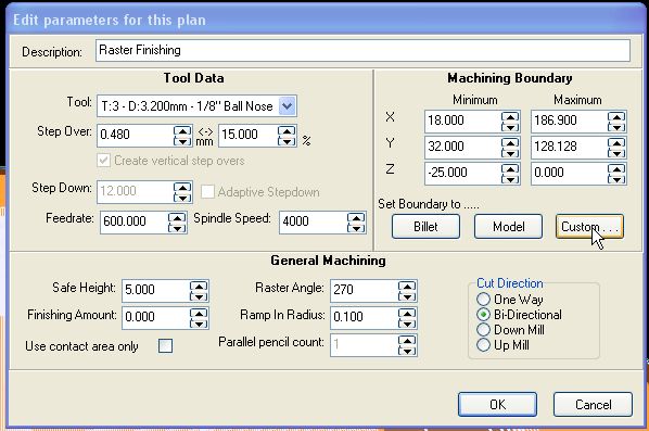

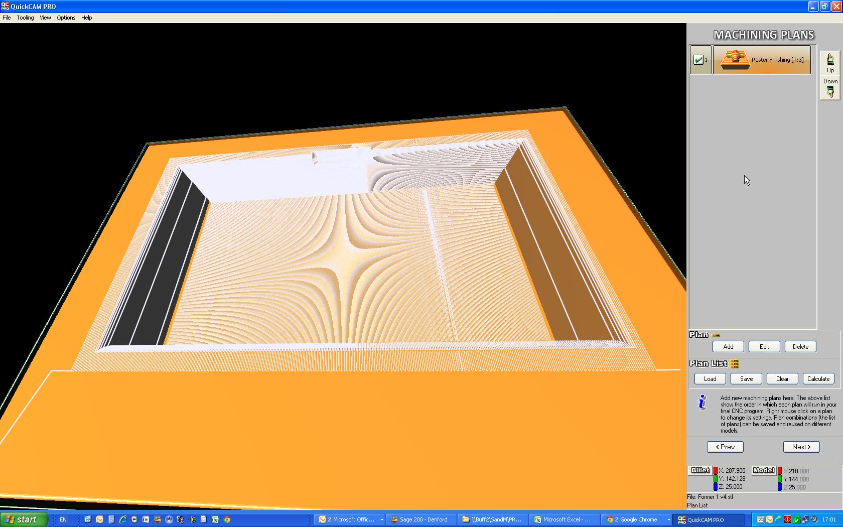

Take the file through the wizard to the cutting strategy page then select the custom boundary option.
You can then change the area that will be machined by changing the values of the X Y and Z to suit.
If you dont want to machine the top of the block set the z start depth at z-0.1 and it will not machine the top
