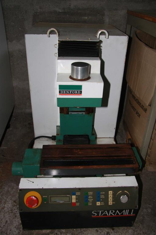

Here is a scanned copy of the software and maintenance manual for my Starmill pictured below. It is for the BBC version running off an RS232 lead.

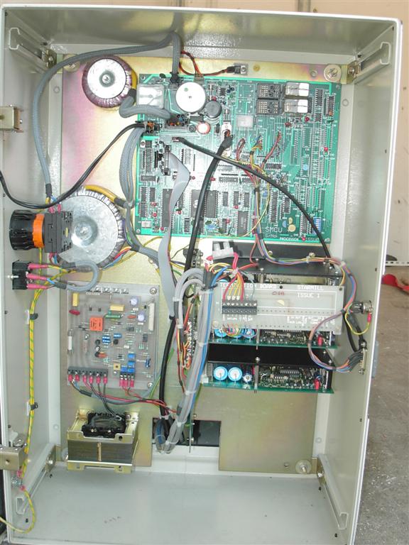

Electronics Cabinet
Electronics Cabinet
Starmill Electronics.jpg (81.12 KiB) Viewed 26658 times
front view
front view
Starmill Front.jpg (46.68 KiB) Viewed 26658 times
