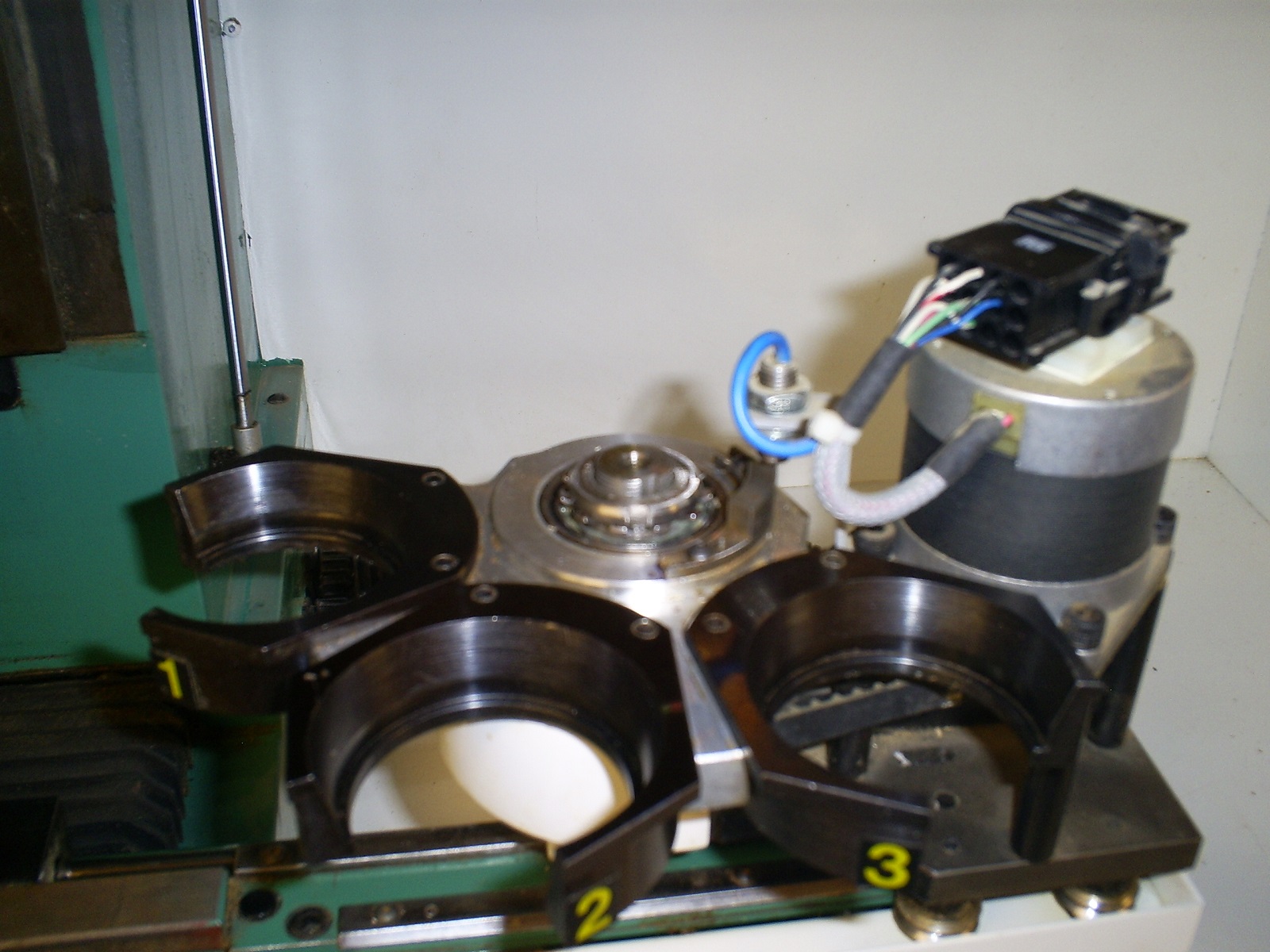

Carried out the checks and all seems to be ok. There is defiantly power to the ATC motor.
The only thing I am not too sure about is the ATC sensor.
When this sensor is in contact with the block I get a 12V reading, when I break the contact it drops down to 6V.
All in all I am confident that power wise, all is in order.
To recap it goes through all the ATC motions other than indexing the carousel.
As anyone got an example of a program with ATC? As I have just been entering T2 which seems to take it through all the motions except the indexing.
Also, is there an illustration for the correct entries needed in the Machine Parameter? settings just in case something is not entered or unchecked.
This is so frustrating, as its certain to be something simple!!
Below is my ATC with guard off.
Re: ATC for StarMill
Hi, Sorry your machine is older than I thought it would be & the ATC will not work with VRMilling version 2 or 5. The only way to get it to work is switch back to Dos software if you still have the original eprom.
