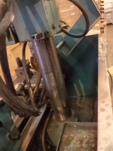

Never seen a Denford combination machine like this one offered on eBay. Was it standard issue or is th emillin gpart a later addition?

Does anyone recognise the mill head as a Denford product? I suspect its a later mod, but who knows? Curious that the vendor talks about the lathe, but makes no mention of the mill part.

Maybe, but on the other hand, the seller isn't trying very hard is he? No description of what, if any, equipment comes with it, no details of what renders it 'not working', no close up photo of the mill head.

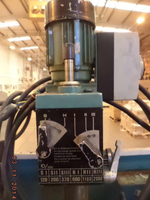

Granted the head seems to be painted the same colour as the lathe and the cross slide looks to have 2 longitudinal tee slots, but on the other hand, where are the mill controls? They are not on the fascia panel, so would Denford make a machine where the operator has to reach over the lathe (true it wouldn't be running) to get at the push buttons? How is the Y axis movement controlled, saddle handwheel? Seems a bit coarse. Also theres nothing on the data plate to suggest that this is anything but a standard Synchro 280.

This is a standard Denford offering - mainly sold to UK MoD, I believe.
There was another one sold on ebay a while back that had the miling attachment still in its packing crate.
The milling unit was supplied by Rishton, according to Tony Griffith's site.
Milling spindle controls are next to the self-contained motor.
A milling table replaced the standard lathe cross-slide.
The lathe's power feeds could then be used for milling - I think there may have been a spindle cap that shielded the rotating lathe spndle. One clearly would not be trying to turn and mill at the same time!

I email the guy for more photos and yes its a milling attachment. Which looks like a separate motor drive to convert if running 230v

I was so intrigued by this one that I went to look at it this morning.
It appears to be a standard Viceroy 280 Synchro, apart from the fact that there is a facing on the back of the bed,for mounting the mill. My 280 doesn't have that facing. Its an imperial machine, leadscrew, tailstock barrel and dials, has the 3 jaw shown in the photos, but no other spindle mounted equipment. There are 2 holders for the QCTP, a tailstock drill chuck and 3 spare change gears, plus various oddments of tooling. There is a 2MT Clarkson type collet chuck and 3 imperial collets which fit the mill head.
The vendor says there is an electrical card problem which stops the machine working. The data plate quotes the drawing numbers for the relevant wiring diagrams, so that probably isn't an insurmountable problem. Both lathe and mill head are 3 phase Its got the footbrake.
The vendor has now been told by his technician, who I talked to, that there is a problem with the traverses, and the technician says that the gears and racks in the gearbox are badly worn and chewed up. Thats a pity, because otherwise the machine looked pretty good, if in need of a good clean.
The mill uses a 6.5"x6" table forming part of the cross slide. It isn't what I'd call a 'handy' attachment to use, if it relies on the saddle traverse for movement in one direction. There should be a quick action movement for the quill, but the lever is missing, and I couldn't spot it in the drawers of the machine. Head elevating is by means of a handwheel on a vertical screw, and is best accessed when standing at the rear of the machine, which is why to me it isn't too handy to use. I couldn't see a name on the mill.

I have 2 x Viceroy 280s, one of them (Ex Gvt) came fitted with a vertical mill which I control with a small phase converter so apart from the mechanical speed selection I can fine tune the speed with the converter! the lathe itself is run on a static converter, the only thing I have to be aware of is to turn the lathe on before the suds pump to avoid the pump being overloaded, of course the pump turns off with the same stop button. If I want to mill only and need suds I select neutral on the headstock turn the lathe on then the pump.
