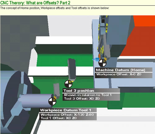

I just cannot get my head around the whole Program Datum, Work Datum, Tool 0 and subsequent Tool Offsets thing.
How do you establish a Tool Change Position and how do you reference this to the work datum?

Screenshot frmo VR Turning help

Hi Steve
Ok - can you tell us where the problem lies?
Presumably you have used the first tool e.g. tool 1 to take a cut across the end of the bar and hit enter to save the Z offset
Then take a cut on diameter, hit enter then enter the diameter. That should be tool 0 set. Ignore tool 1,Then put tool 2 in - jog until you touch the Z face and hit enter. Then either touch the diameter or take a cut. Hit enter then enter the diameter.
If you look in the tool table it should be something like this
Tool 0 X12.345 Z134.234
Tool 1 X00.000 Z000.000
Tool 2 X06.111 Z12.213
Remember the the Orac does not have home switches so you need to setup the tool offsets every time. Assuming you have your tools in holders, the easiest way is to write the values down on a piece of paper, or if your lucky you can save them to a cassette. You then just need to set tool 0 (tool 1 in reality) everytime you start the machine and enter the tool table values.
Hope that makes some sense.
