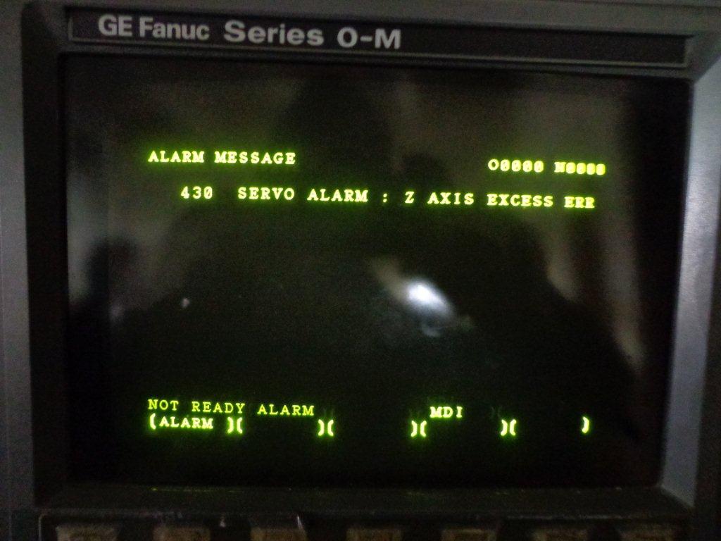

sir fist of all many thanks for providing me the parameters list.
i have entered all parameters according the list but i did not know how to call diagnostics on the control screen. second thing all previous alarms are cleared know but a new alarm message is appeared, i am sending you a photo of this new alarm.
i am waiting for a kind response.
thanks
jamil

You should have a button labled DGNCS/PARAM or similar that togles between parameters & diagnostics. You may need to be in Edit mode to change the values.

I have the same problem as pic attached By Mr. Jamil.
Kindly help me out.
Salman
Re: GE FANUC SERIES O-M 430 SERVO ALARM
Does the axis jump slightly when you power it up?
Also is the axis free to move? (Can you turn the motor pulley or leadscrew).
