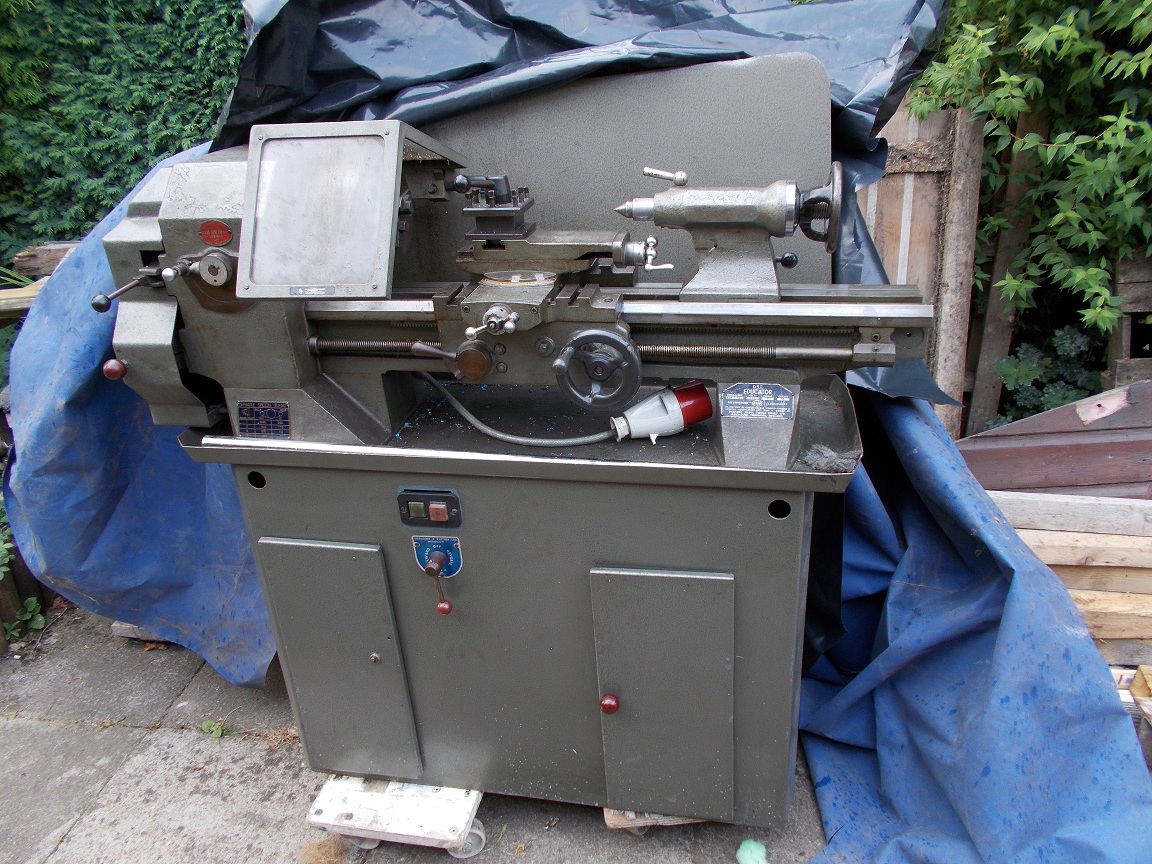

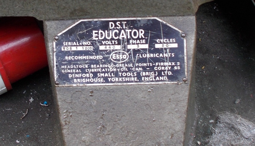

Just got an Educator TDS 1 serial no 1205 no clue as to age but would think its quite old.
Im just working on the best way to power it swap the motor for a 240v or get an inverter or similar.
I may yet strip it down repaint ect not sure at the moment
Can anybody tell me what the chuck spindle size and thread is ?

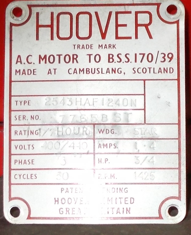

Can this motor be made to run on 240v some how ?

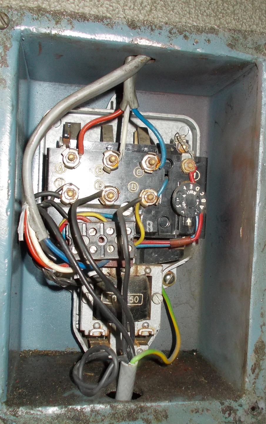

What is this for ?
What is this for ?

I don't claim to be an inverter expert, but thats a 440V motor the OP has, not a dual voltage 240/440, so the normal type of inverter, inputting 240v single phase and outputting 240v three phase, won't work on it. However, the www.lathes site has a section on electrical matters and apparently there are now special inverters which will do 240v in 440v out.

If you have a look inside the motor terminal box and find three seperate windings terminated
as per the diagrams, you are made. If not you will need either a special inverter, a new motor,
or to find and lead out three wires from the star point.(probably a specialist job).
The motor will run, by the way, as it is but will be very low powered.

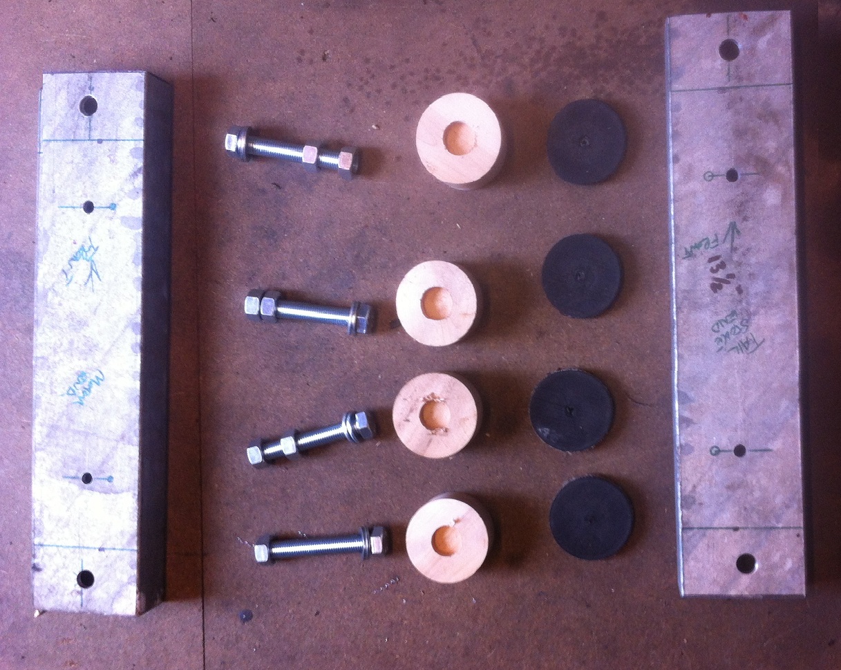

Have manage to wiggle lathe in to work shop and then found out how low it was so made some feet for it
Out of 4" channel spun some wooden extension bits with some old conveyer belt glued on the bottom mounter on m16x100m bolts
For now have bought a 240v 1/2 hp motor which is not up to the job but it was only £12 I shall be keeping a look out for a suitable replacement.
