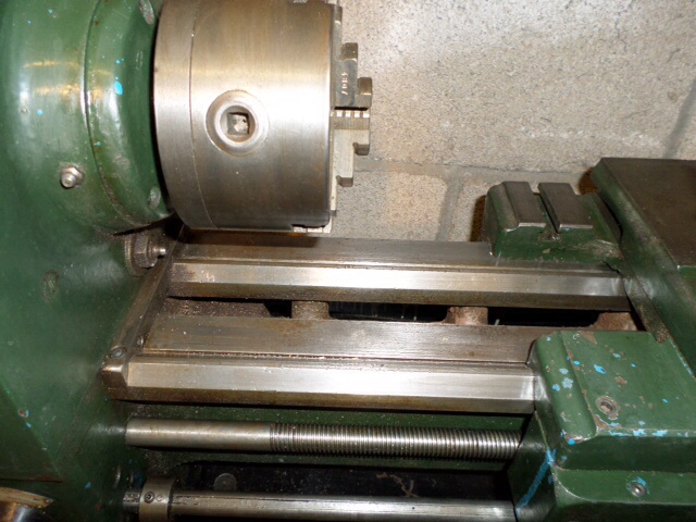

I am new to the forum and have just acquired a Metric TDS 1/2 PCS with a view to learning how to use it for making small parts for steel bicycle builds. The lathe was working when I collected it but I had to break it down by removing the apron from the bed, and the bed/headstock from the cabinet which required unlinking the brammer belt between the intermediate pully and the headstock. I have put it all back together but need to reconnect the belt and can't see how it can be done because it was under slight tension when removed. There are two tensioning screws holding the intermediate pully but they are rock solid.
The lathe is ex-college and doesn't seem overly worn but has been mistreated as evidenced by the dings in the bed. The changewheels are missing but it does have 3-jaw and 4-jaw (missing backplate) chucks, tailstock chuck, steadies, quick change toolpost and various tools. I have downloaded all the manuals and drawings and figured out how all the parts and switches work but am still puzzling over the belt.

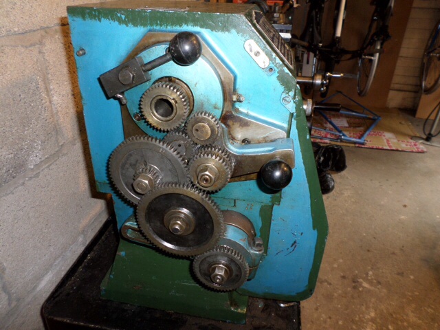

Its fine and only too pleased to help if I can. I have a 100 tooth change wheel here but I am missing the compound 66/18 tooth change wheel from the full set. The change wheel setup is shown in the hinged end cover for the lathe. There are 2 versions of the lathe; one metric and imperial. The lead screw and the change wheel carrier are specific for each type of lathe. I suggest you refer/search for posts on the forum for more details.

Thanks for your reply. I have enabled the pm but probably best to communicate on the forum for the benefit of others. From looking at the drawings this is what I understand a full set of idler and changewheel gears for my metric lathe should be. The ones which I posses have indicated with 'Yes' :
Changewheels
16t
20t
24t
28t
32t Yes
40t
48t Yes
80t
Idlers
66/18t Yes
72/18t Yes
100t
I recently bought some 27t, 18t, 22t, 24t, 66t, changewheels on ebay from a Viceroy lathe but they have a DP of 16 rather than 18, so from a later model I suspect - lesson learned!
As you can see, I am missing quite a few but do have the compound gears. I have set up the gear train using the wheels which I have. It looks like there are various washers and spacers that need to be present in order to line up the gears, so this is what
I was wondering about.
Thanks greatly of the offer to compare your set-up but I am in Plymouth so a trip to Staffordshire would be a trek. If I am up that way I will let you know and take up the offer. In the meantime I will post some detailed photos of the parts and how I have arranged them.
