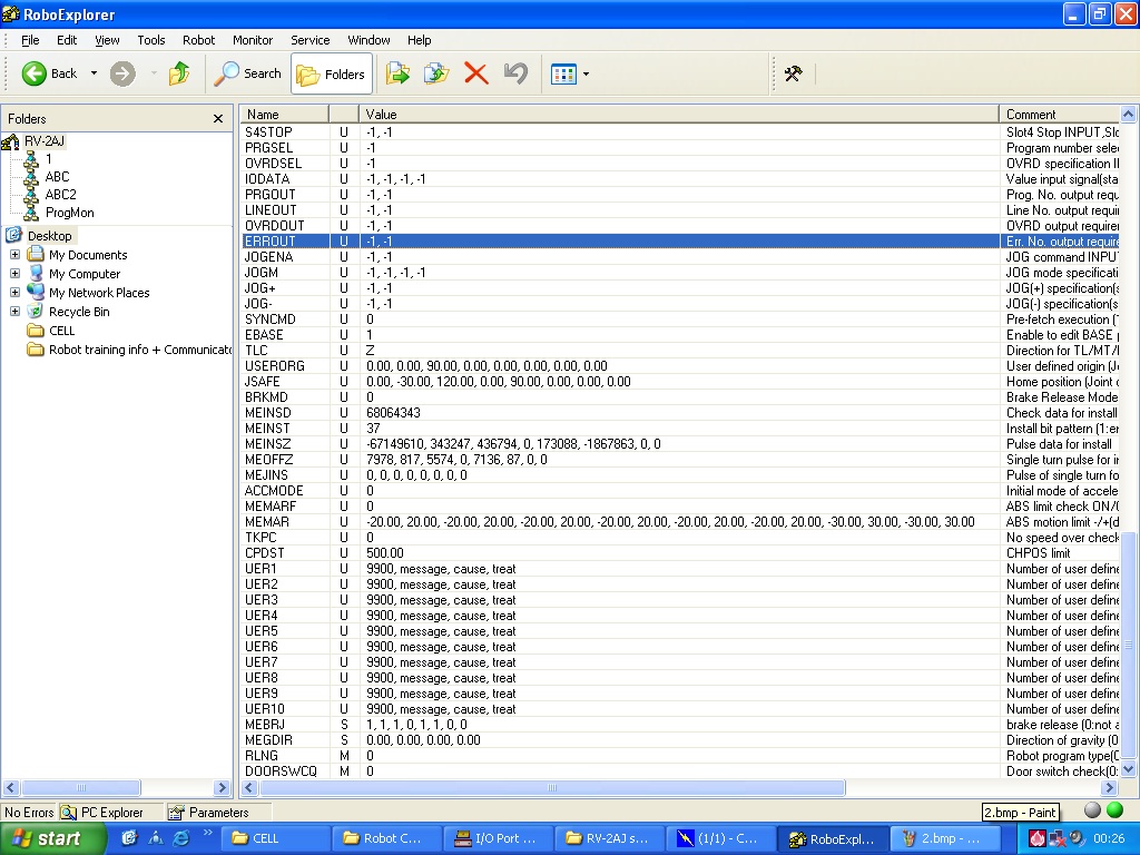

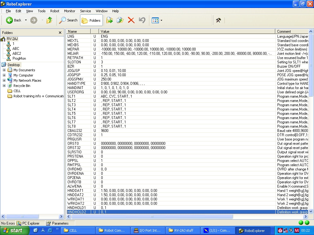

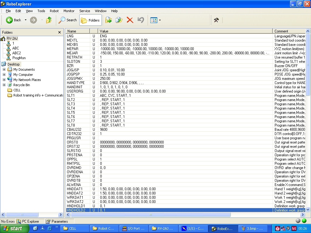

As I previously Describe we have two robots, One with Mill Machine, other with Lathe Machine,
I retrive list of parameters in those robots
Robot attached with Lathe is Working Perfectly Fine
But Robot Attached with Mill is not being controlled by robot Communicator.
I am uploading parameters details of both robots.
Kindly help me to resolve this problem as I have to complete My project as soon as possible.
Lathe Page 3
Lathe Page 3
Lathe 3.jpg (283.82 KiB) Viewed 41339 times
Lathe page 2
Lathe page 2
Lathe 2.jpg (258.02 KiB) Viewed 41339 times

Mill Page 3
Mill Page 3
Mill 3.jpg (284.9 KiB) Viewed 41339 times
Mill page 2
Mill page 2
Mill 2.jpg (259.13 KiB) Viewed 41339 times
Mil Page 1
Mil Page 1
Mill 1.jpg (289.53 KiB) Viewed 41339 times

I have Compared it ........
Parameters values of MEINSZ
MEINSZ
MEOFFZ
are different
Re: Robot Issue
Those look to be related to the joint encoder pulses (ie, positions)
You'd probably expect them to be different.

What I Figured Out is
Some thing is missing
I wrote a program but it gives a error executing it which is
L4910 Error message Robot Language is mismatched
Cause The parameter RLNG is mismatched. (1:MELFA-BASIC Ⅳ , 0:MOVEMASTER command)
Measures Re-set RLNG or select an other program.
