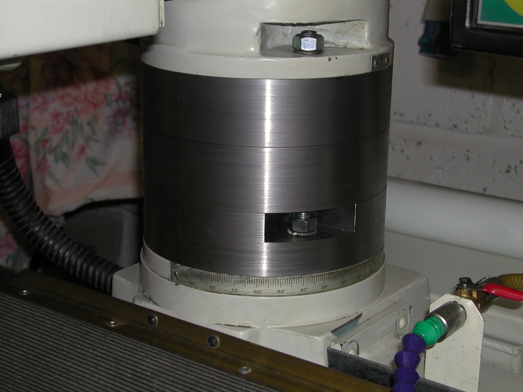

The riser is made of 3 of 2" x 8" discs bolted together internally with appropriate cut outs.
Just as well I have a big lathe!
It has revolutionised my work on the mill, I can use a large machine vice without running out of headroom and I can still bolt workpieces direct to the bed and reach them.

The discs are bolted together with M12 allen bolts internally, the top disc has studs set into it for the head to sit on and the bottom disc sits on the original studs, hence the cut outs to allow bolting down
The tricky thing is alignment, I drilled a M10 hole dead centre in each disc and used this as the reference for all the other operations, both in the mill and the lathe
Afraid it was back of an envelope stuff, I just had measurements and the stud PCD written down somewhere and worked from that
regards
A bit of a close up showing cut outs etc
