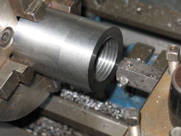

This photo is out of order.  It shows internal threading using a boring tool made for the job.  Making tools to make more tools.

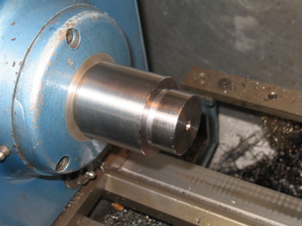

The adapter internal thread was tested with my very first project.  The spindle to 3MT adapter has exactly the same thread as the lathe spindle.  I was able to test the internal thread for fit without removing the work from the 4-jaw chuck.  As a final check, I removed the 4-jaw chuck with the work held in it and screwed the new adapter onto the lathe spindle.

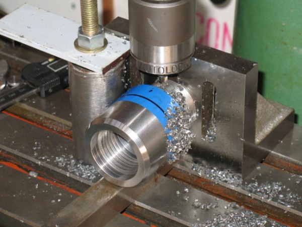

Machining the C-spanner slots.  The workpiece was bolted to the angle.  The workpiece sat on a piece of key steel.  The vertical tube fixed the lateral position.  This mean't I could rotate the workpiece and clamp into the right position for the next cut.

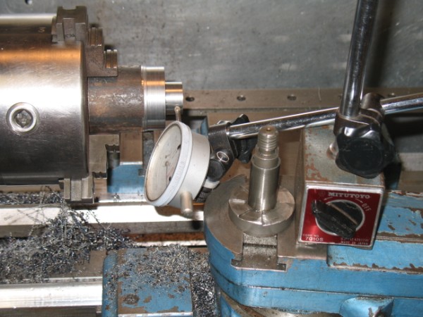

Using a machined step and trig to set the cross slide angle.  I measured the diameters, and then calculated how far the top slide had to move to get a zero reading on the other step.  It takes time to set up, but provides very accurate results.

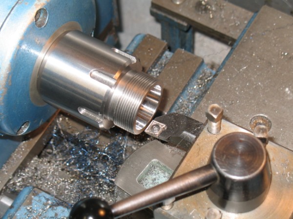

Machining the tapered bore using a cermet insert.  These make an excellent finish.

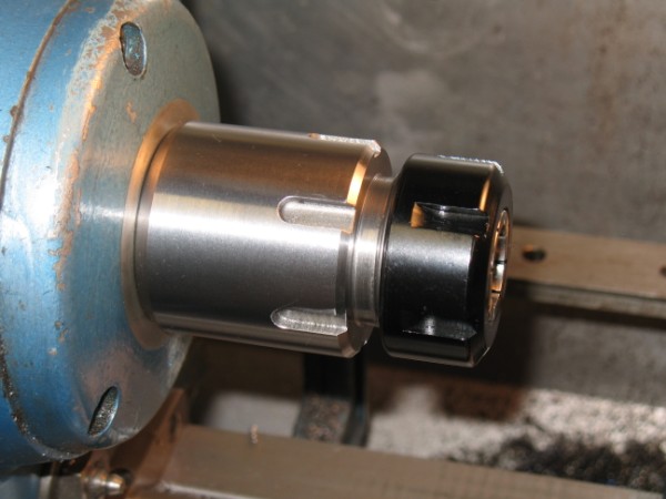

The finished chuck
The finished chuck
