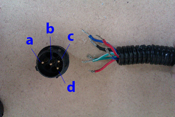

Hi All, This one is rather embarassing as its the result of rough treatment when removing the 4th Axis to free up room on the bed.
Now I have finished cutting my 2D stuff I have reattached the 4th Axis to the bed and the memory came back to me from when i disconnected the communication cable a few months ago with an ape like twisting pulling motion!!!!!
Needless to say it hasn't done the connections any favours and I now have 4 pairs of wires that should be connected to the contacts within the plug. I'm pretty sure I can get it all back together again as nothing is actually broken but would like some info on:
How the wires are paired
Configuration of the contacts
Ashamed of myself!
Ashamed of myself!
Denford 4th Axis cable.jpg (65.02 KiB) Viewed 21904 times

Ah! doesn't look like I will be able to fix this afterall as i've damaged the plug trying to get the pin contacts out. looks like i'll be ordering a replacement cable. :oops:
Re: 4th Axis rough treatment
4th Axis plug
Old Version
Pin No Colour
A BLACK
B ORANGE
D RED
E YELLOW
New Version
Pin No Colour
A RED
B BLUE
D BLACK
E GREEN
If it's a 8 wire motor then use the following.
Red & Blue ------------------ Red
Red/White & Blue/White ------- Blue
Green/White & Black/White ---- Black
Green & Black -----------------Green
