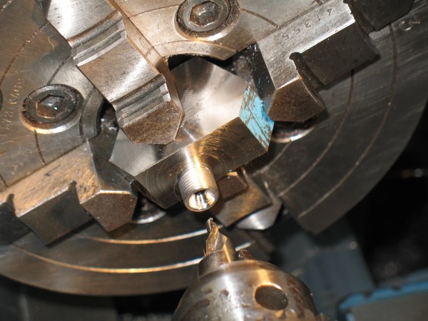

The hexagonal stock made it easy to index the workpiece as each port was machined.  Note that the hole is intentionally off centre in two directions.

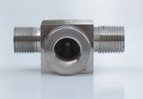

A general view of the finished adapter.

The through hole is intentionally offset to make it easier to bleed the brakes.

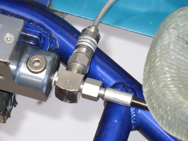

The hydraulic adapter fitted to the kart brake system.
