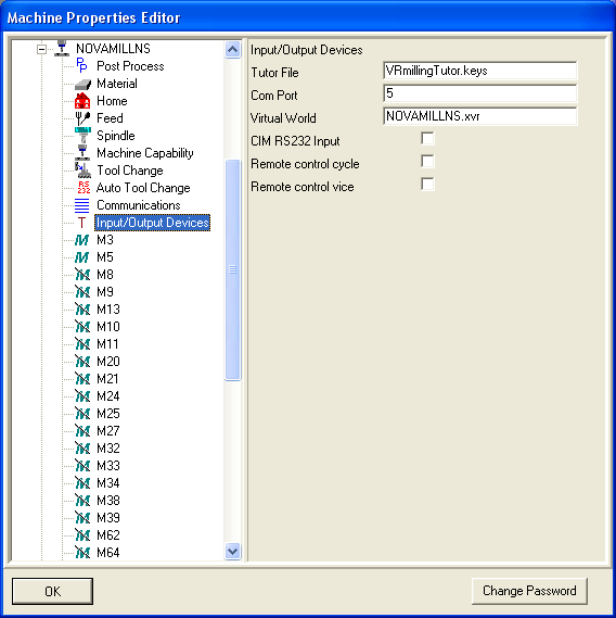

It looks as though M62 is supported in v2 milling (I checked Novamill.mnt and NovamillNS.mnt one of which will be the logic file it uses for your machine)
One of the mints requires CIM mode to be enabled. That will be set in parameters and activated with one of these options:
(The password to edit parameters is denny btw)

Denford Admin wrote:It looks as though M62 is supported in v2 milling (I checked Novamill.mnt and NovamillNS.mnt one of which will be the logic file it uses for your machine)

Apparently, the Parameters screen only went up to M8, and stopped.
I found another thread that mentioned "Hopefully the fanuc pmc logic in your machine has the CIM auxiliary I/O code in it".
Ah... could it be that we don't have the full software package? Can't turn on the CIM mode if it doesn't show in Parameters.

Re: Robot to CNC handshake
The mcodes in the list are nothing to do with it,
I meant that turning on one of these options will enable M62 in the machine logic:
CIM RS232 input #
Remote control cycle # (think it'll be this one)
Remote control vice #
The mcode does not have to be listed in parameters, you can program any code whether it's in the list or not.
All the list does is enable an mcode in the control panel's drop down list.
