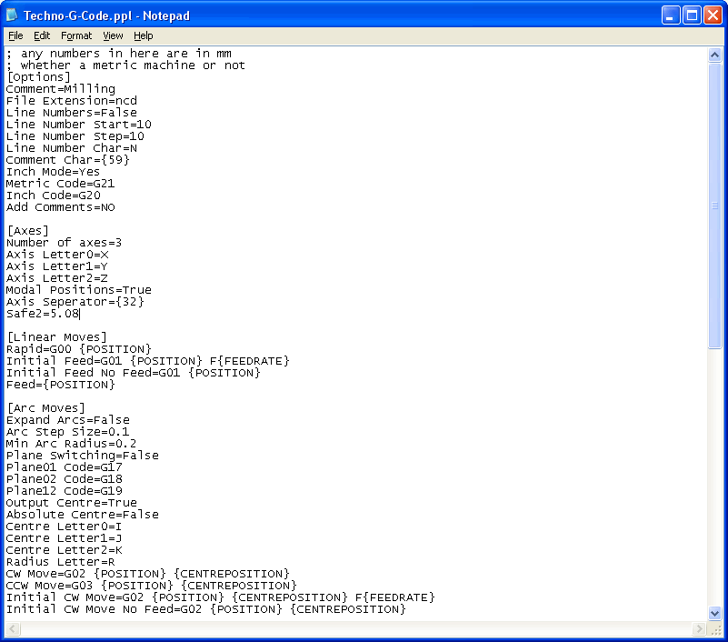

I was wondering if it is possible to modify the post files "parameters" in QuickCAM3D. For example, when I create the NCD file using QuickCAM3D and open the NCD files for my Formula One car, the Z value keeps sending my motor/bit too high on the Z axis, hitting a limit switch. I usually have to modify the NCD file (set the Z to 0.0000 rather than Z=0.1969). Is this possible? I have a Techno Isel Davinci stepper motor mill. Thanks.
Re: Alter default safe height in Denford post processor files
Yes it's possible.
Locate the appropriate post file, usually in this directory:
C:\Documents and Settings\All Users\Application Data\Denford\Posts
(You may need to turn on hidden files/folders to see it)
In this case, the file will be Techno-G-Code.ppl (nb the filename is exactly the same as it appears in the software)
Open the file in a basic text editor like Notepad
Look down the file for Safe2=5.08
Safe2 is the safe height position for the Z axis (ie 0=X 1=Y 2=Z)
The post setting file is fairly easy to work out, and there is also a file called posthelp.txt which explains some of the features should you wish to make your own post file...
Thanks for that, I checked the z position across the 25mm sacrificial board and there is a discrepancy! must be because the cut surface of the MDF has alowed the atmospheric moisture to enter from that side.
I have been into the post file and altered the Safe2 from 5.08 to 10mm and saved. However now I have come to do a test run the macxhine says that the z axis is in motion when I try to home the axes and it's definately not in motion - the z axis displays right up through 1000mm!
