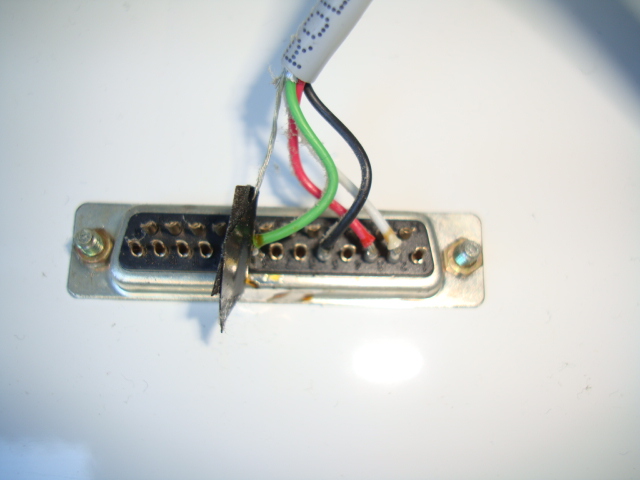

here are the connections mounted on 25 pin d-sub connector on side of cabinet
