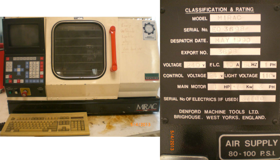

A Mirac without system disk has been donated to our students’ workshop. You can see it below:

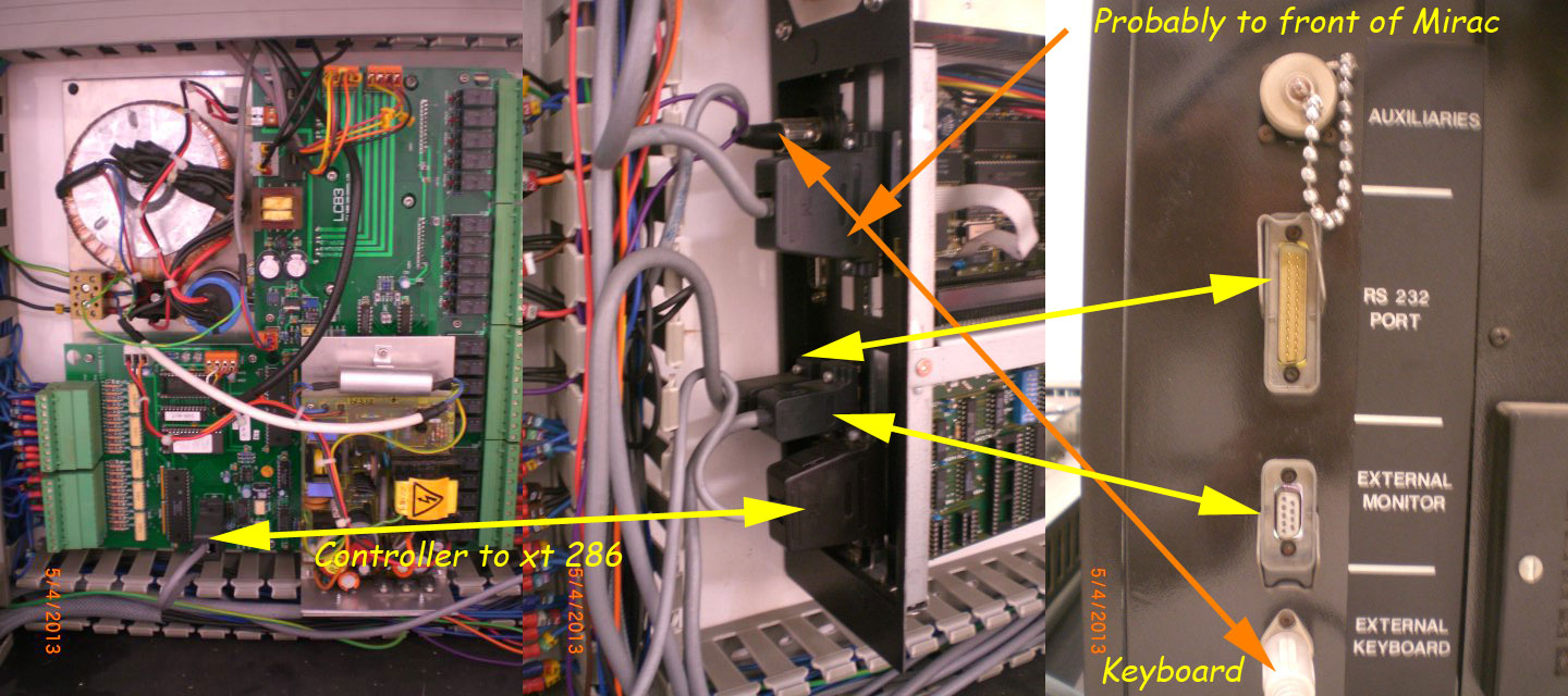

You can see configurations of mirac connections below:
Do you have any about idea our mistake? Or content of mirac.go and macmirac.go?

Mirac's fixed overlay fanuc desktop tutor works properly. I've double checked all ports and its address on XT 286 with it.
No problem seems on system and Mirac DOS software disk.
Also, I've checked fuses on circuits. However, there is no power at any indicator LED on circuit.
Still has "Error <50> Mirac controller slave disconnected." then "Error <128> Software aborted."
Where should I check next?
Re: Mirac "Error 128"
Sounds like you need to trace the supply with a voltmeter onto the LCB3 board and look for fuses / diodes / thermals / capacitors which may have tripped or blown.
