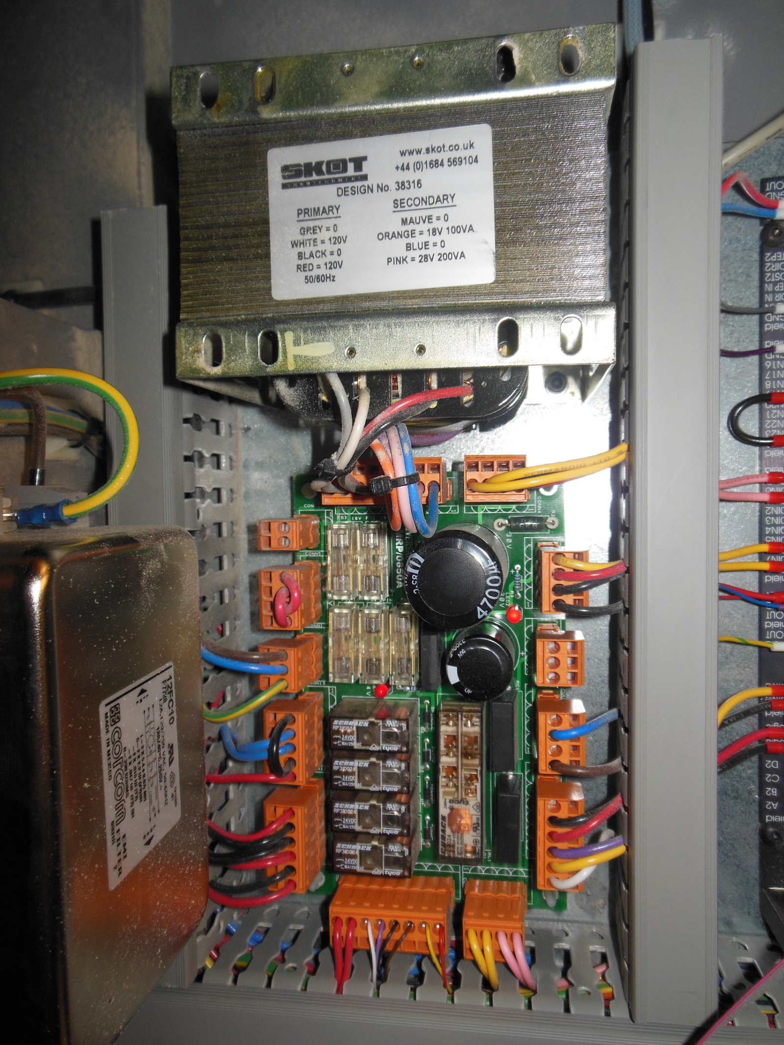

Here's the picture of one board. I'll post the other in the morning - we had some minor camera issues today.

In the photo shown both LEDs on the distribution board are lit and you say the stepper drive LEDs are green indicating that the E Stop relay has been energised.
The signal to the Next move comes from a contact on the EStop button and if the machine is a pro it could be in series with the spindle drive status.
Is your machine a Pro? If so what is displayed on the spindle drive? It should say stop to indicate it has power. If the display is not lit then this could be the problem.. Also if you stall the spindle and the drive goes into alarm it has to be powered off for over a minute to clear.
It could also be a faulty estop contact on the button. One contact operates the relay which is working the other operates the signal to the control card.
Can you post a photo of the E Stop button? Also take a photo of it.
Operate the button a few times and vacuum the contacts at the back of it while you do this (with the power off)

Also take a close look at the contacts on that large relay on the right of your photo.
If you press the estop button in and out, all the contacts should move...look out for one that doesn't

There is significant arcing in the large relay, the upper set of contacts second from the left. You can see the discoloration in the photo. Also, are the stepper driver LED's supposed to be off when the e-stop is pressed or should they be red? They are green when the e-stop is released.
Re: 2600 emergency stop won't clear
The arcing on the Estop relay is normal and this is not the problem.
The spindle drive is at the top right of the electrical panel and will be purple or yellow. There is a display on this. If its not lit then the drive does not have power. The normal status is that it says stop. It will display the frequency or current when the spindle is running.
The fact the LEDs go green shows the drives have power which is normal.
