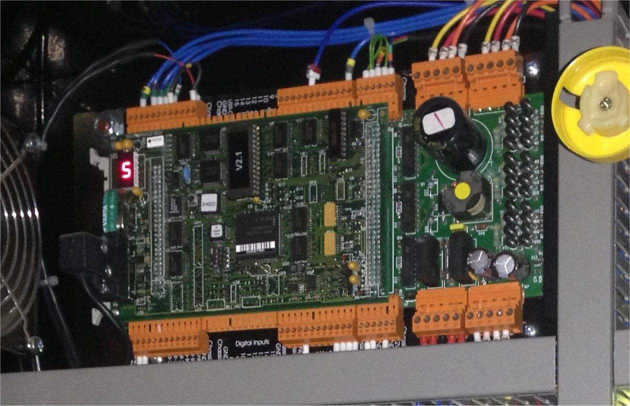

Just got hold of a Microrouter V3 with Denstep card and V2.1 Rom (see attached pic)

Re: Microrouter V3 and VRmilling V5 - which Mint file to use
From V5 you should be selecting Legacy Machines and Router Denstep.
None of those mints you mention will work on the Red LED denstep boards.
See selecting and configuring the machine PDF here:
https://denfordata.com/bb/viewtopic.php?f=2&t=2903
