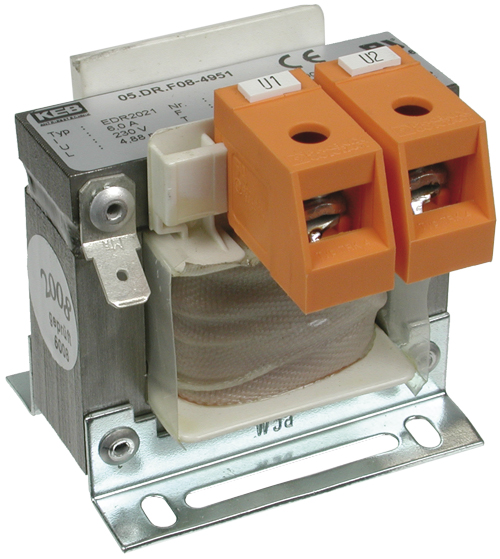

Re: Wanted ORAC Spindle Drive Choke
Hi I might have one
I will need a photo of the one you have as I don't know what it looks like but as I am using a vfd you might be in luck
bert
Hi!
I have need for one of these too. They are rated for 100Hertz or maybe 150 max.
cheers

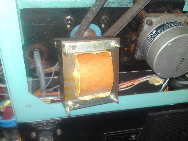

Hi I shall have a look tonight. pretty sure there is on still fitted not being used.
...That was instant response Bert. I thought there was no hope to find one.
Thanks!
Dimitri

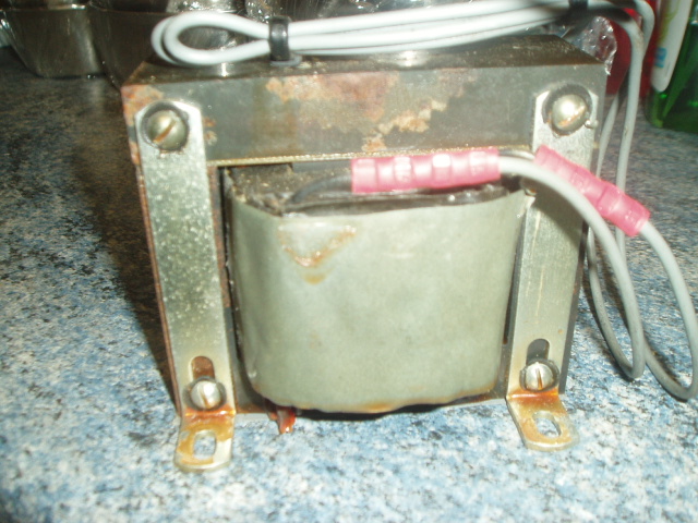

Hi I think this is the one
Not sure how to test it
checked with meter and all I can say is it does not have an open circuit.
Hi Bert!
Good job...If it is a two terminal inductor it has to be the one. Could you please read the Impendance with your DMM?
If it reads nothing no problem I'll fix that.
But anyhow, if you took it out of an Orac lathe and it is something you may not need any more you do not need to make any tests. This is just what I am looking for. Because the red wire ends/connectors look pretty similar to those in my machine.
Just let me know what are you asking for this and I'll send you my email for the rest.
Cheers!
dimitri
Hi.
Hmm On the 200m meter setting it reads 01.0, and that is the same if I touch the meter leads together.
Price ? don't know what they are worth.
...It looks like I've found a replacement. An electrician friend of mine took one out of a 350watt road lamp power supply. This was in a unit he had replaced. It reads 1.8 amps. Connected that in place of the missing one and got the inverter back to life.
And... last night I also found that old computer switch mode power supplies they all carry one.
I am happy again.
