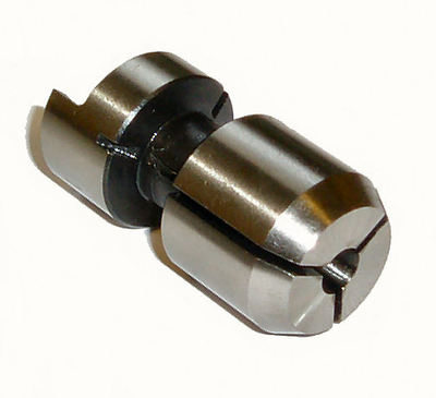

However I thought the 'C' type collets were an externally threaded draw in type. My chuck uses Posi-lock collets and I expect yours uses something similar. I can see that resting the collet on the radial grubscrew would enable the nut to be tightened, but wouldn't it also prevent the female centre in the end of the cutter contacting the male centre inside the tool holder?
These chucks would work fine if the centre inside the tool holder could be adjusted axially as described in the manual. However the centres in my holders are fixed.
POSI-LOCK COLLET.jpg (16.42 KiB) Viewed 12090 times

It maybe that you have an osbourne holder not a clarkson. They work the same but the osbourne holder has a different shape back to the collet.
https://www.ebay.co.uk/itm/NEW-POZI-LOCK ... 19d244c8c4

Coventry is the manufacturer/designer of the taper lock holder/spindle adapter, and clarkson/osbourne is the design of the collet. The common clarkson type holders that come with the Denford mills are osbourne holders that take the posilock collets, and have a coventry taper on the back to fit the easychange spindle adapter.

Thanks for the clarification. Yes, Coventry EASY-CHANGE chuck with Osbourne cutter holders and posi-lock collets. (The Triac Manual shows taper collets which I believe are Coventry types).
The posi-lock collets are identical to those in my Osbourne Titanic chuck, but the centre in the Osbourne chuck is longer than that in the Osbourne holders. This means the cutter doesn't have to be screwed in so far in order to prevent the screw collar bottoming.
My problems with cutter shafts splitting must be down to over tightening.
