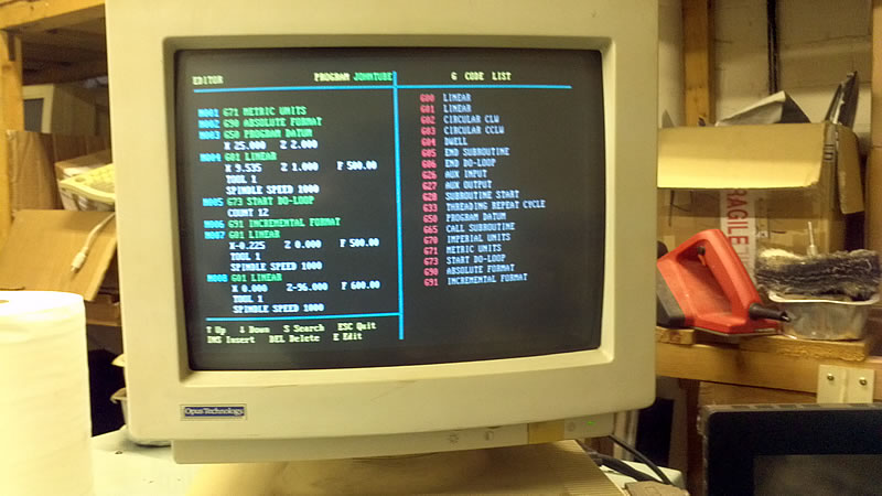

Think you have a typo somewhere in your program, seems to me each traverse in the loop moves the tool further from the bar end.
p8 moves to 94mm actual cut length, p9+p10 position tool at 4mm from bar end, that = 3mm from loop start position, this is multiplied by 12 for the program.
Rgds, Emgee

Well spotted, yes, it was my bad typing, should be OK now :D :D
See image below for the original :D :D :D

Hi Rob
I believe you still have a problem with the program for the finished dimensions quoted, your workpiece will finish under the 15.80mm diameter, typo at p13 X needs changing, also you don't have any spindle start or stop commands in the program, do you start/stop manually ?
It may have been simpler to have gone ABS at p12 so p13 could be Z 1.00 and X 7.90,(finish diam).
Rgds, Emgee

Nope, works fine, the old system is a bit odd compared with todays way of doing things :D :D
The Orac was always a manual spindle start, when started it is at a very low speed, motor is "cogging" really, a short press of the + key will speed it up and then when the program is started it then takes over the output of the 0~10V DC analog signal to the VFD spindle drive, very simple system.
The change at P12 is for a finish pass and has to be written outside the main program, that`s the way the manual has it shown to be done and it works OK for me :D, done loads of stuff on it, including threading which it does quite nicely indeed :D :D
