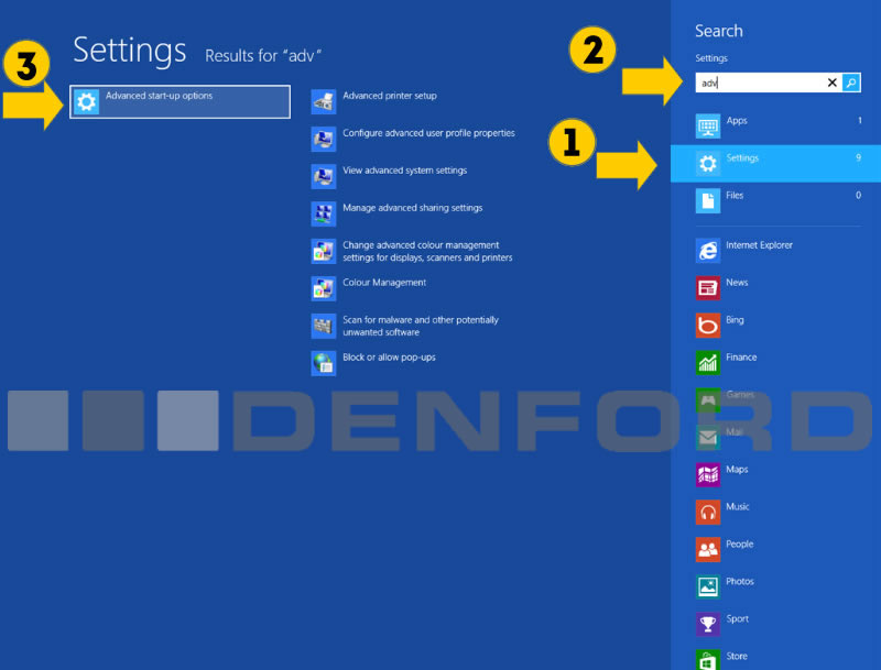

Move mouse up into the Top/Bottom Right corner and pick Search:
Then pick Settings, type Advanced… and you will the advanced options appear:

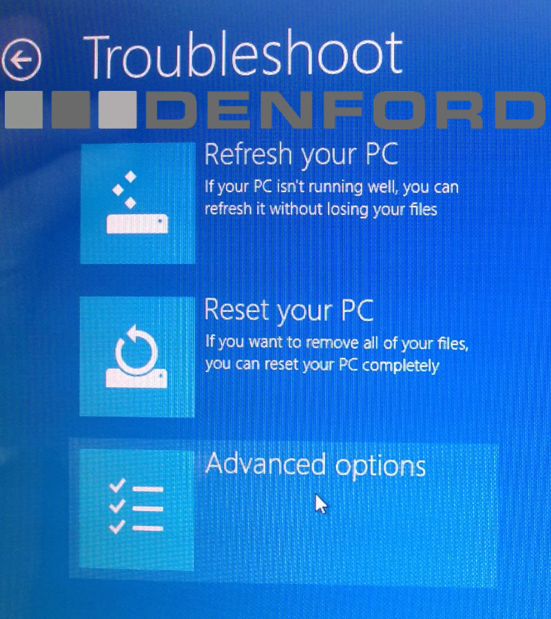

Now pick Troubleshoot:
Now Advanced Options:

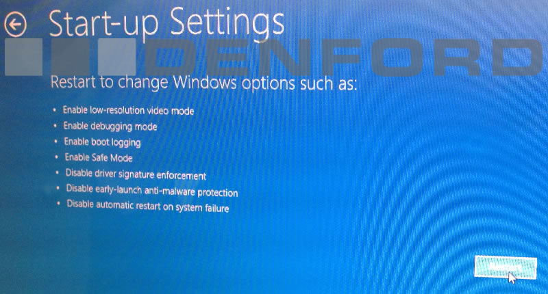

Now pick Start-up Settings
Now hit the Restart button

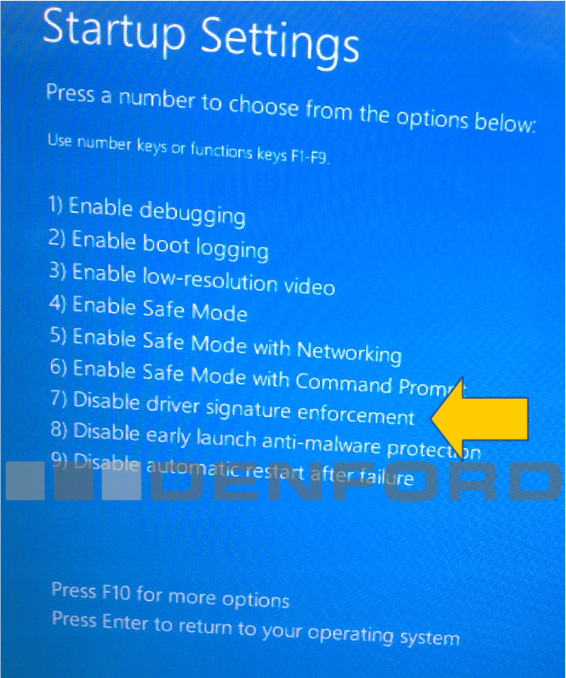

You can now choose to Disable driver signature enforcement by pressing the key 7 or F7
That’s it, you will now be warned about installing unsigned drivers as you were in previous Windows versions instead of a complete failure to install.
