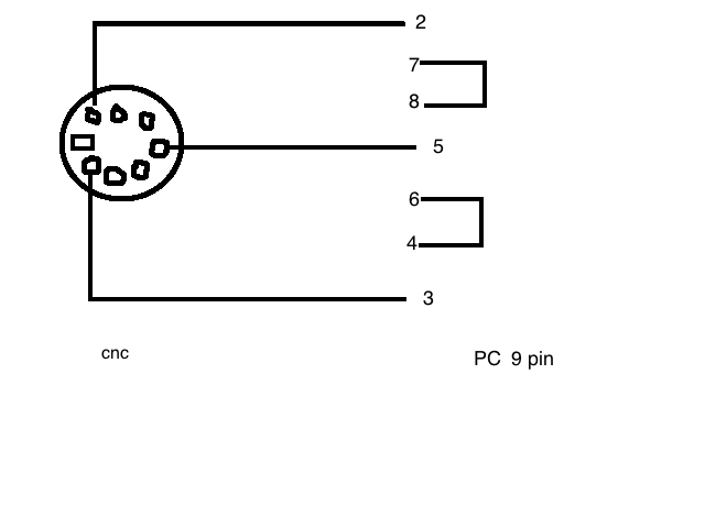

i have a easiturn 3 with PNC 3 and i have make a cable like shown in the attached picture. I use a 9 pin Male on pc side and a ethernet cable (ethernet has 8 cables in it and i use the 3 of them) lenght of the cable 1.5meter. I am using a windows xp pc.

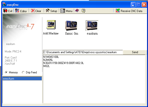

I attach a picture with my easyDNC settings and my G code with i have sended from my cnc.

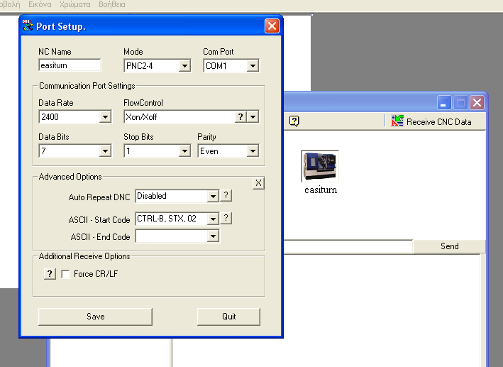

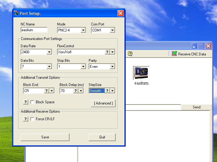

settings 2.PNG (32.09 KiB) Viewed 22945 times
settings 1.PNG (168.77 KiB) Viewed 22945 times

I think there could be a couple of reasons for this. Either
a) the PC is sending all of the CNC program but the control only recognises the first block.
b) The PC sends the first block and is waiting for the control to request the next block.
I am not familiar with EasyDNC but here are some suggestions...
1.Try turning off the XON-XOFF flow control (set it to "no flow control" or similar). You may also have to increase the "Block Delay" to something like 1000ms. This solution will not work for Drip-Feed but may work for storing a program in teh CNC.
2. Try changing the Stop Bits to "2 stop bits"
3. if the PNC control has a "Paper Tape" option on the screen then try this (Paper Tape option used Xon-Xoff type flow control)
HTH

I have tried all this configuration and a lot different combinations... I will try tomorrow more .
It must me a configuration problem. The program that denford used to provide (i have found it in a .zip file here in the forum named old machine software.It is a dos programm) makes the same think. It recieves but sends only the first line to the cnc and then waits. The easyDNC says Waiting for CNC so i supose that the problem is on the cnc side because it didnt send the signal to the pc to send the next block. :/
i am confused and have a headace i was 5 hours trying different configurations on the cnc and the pc... If some one has a suggestion please let me know :) thank you very much in advance
