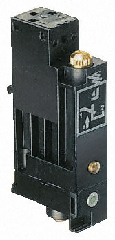

do you have any foto of < the air pressure switch > and where is it on the machine ???
I want to know what looks like

It will be located near the air solenoid blocks ... where all the air pipes start off from.
There will be a black cap with a symbol on it like this:
Re: ERROR NUMBER < 5 >
We think it may look like this
RS Stock No. 723-006
Brand: Crouzet
Mfr Part No. 81513502

If you turn the machine off & then link both wires that go to the air pressure switch together that will bypass the switch.
