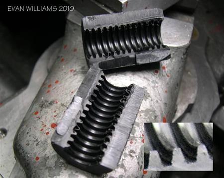

I then decided to crack it open to see what the threads look like. It took quite a bit of force to break it open. I wasn't expecting the threads to look this good.

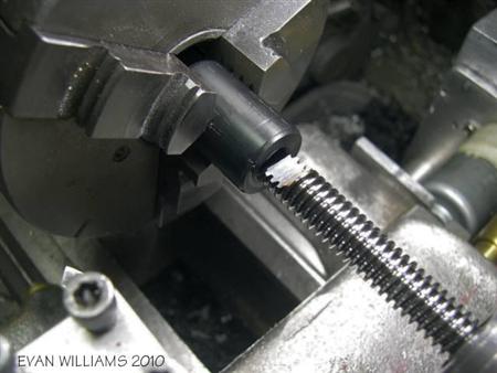

In the picture where the leadscrew is chucked to the lathe, how do the two halves of the plastic hold together? Is it the heating that bonds the two?
The melted acetal squeezes out into the kerf and heat welds the pieces together. I wouldn't depend on it in use so it would be a good idea to make a sleeve either from acetal or metal and press the nut into that.

What is the melting temp of acetal? Are we just going right up to the melting threshold with the heat?
Short answers: 338F (170 Celsius), Yes.
Long answer: Acetal is limited to a maximum working temperature by the heat deflection temperature. This is load dependent. At a couple of hundred psi ( easily applied by the vise) the deflection temp is about 250F. This is when it begins to thermoform and consequently the amount of heat transmitted from the screw to the acetal increases as the contact area increases. As the temperature continues to rise the material softens further until liquidus is reached. This is easily observed as the acetal will quite suddenly start to flow. At that point the vise can be tightened some more and the acetal will squeeze out into the kerf and out the ends. It is important to heat mainly the screw as we don't want to melt the entire mass, only the inner portion.
