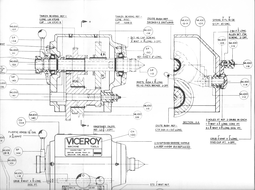

Re: Viceroy Gear Selector Fork
Hi I found a drawing which might help.
Regards,
Les.T.
Part of Drawing ML100/100B
Hi Les,
Thanks for the drawing.
It seems to confirm that the two phos. bronze rivets in my lathe are not doing what they are meant to.
I will have a go at removing the gear shift lever gaining access from the rear panel next weekend.
If this fails I think it will be a head stock removal job.
Bob

A Viceroy re-build article provided by the 'CNC Apprentice' has been a great insight and help in sorting this problem out. Many thanks to CNC for that.
The two phos. bronze rivets (see CNC's photo) on the back gear shifter fork (ML100/109A) were found to have worn allowing the inside of the fork to strike against the back gear.
Replacing the rivets and dressing them with a file to ensure that there was an equal gap on both sides of the fork arms has enabled the fork arms to maintain a centralised position about the back gear. This has now brought the noise level down to an acceptable level.
