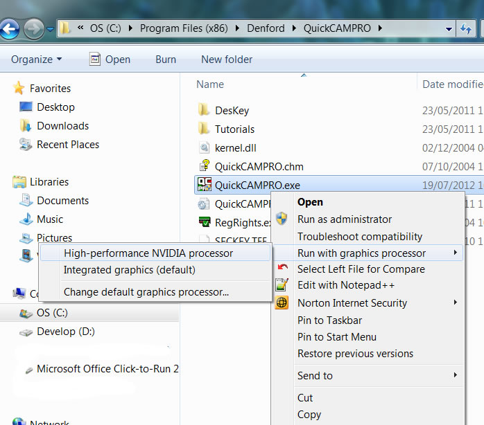

We know it for sure because we can see the issue on our Dell XPS15.. you can run the application using the integrated graphics card, or tell it to use the NVidia high spec card. When we run with the NVidia we don't get a problem, whereas we do with the integrated card.

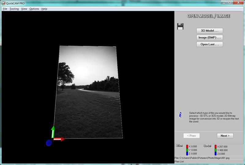

If you see this...
If you see this...

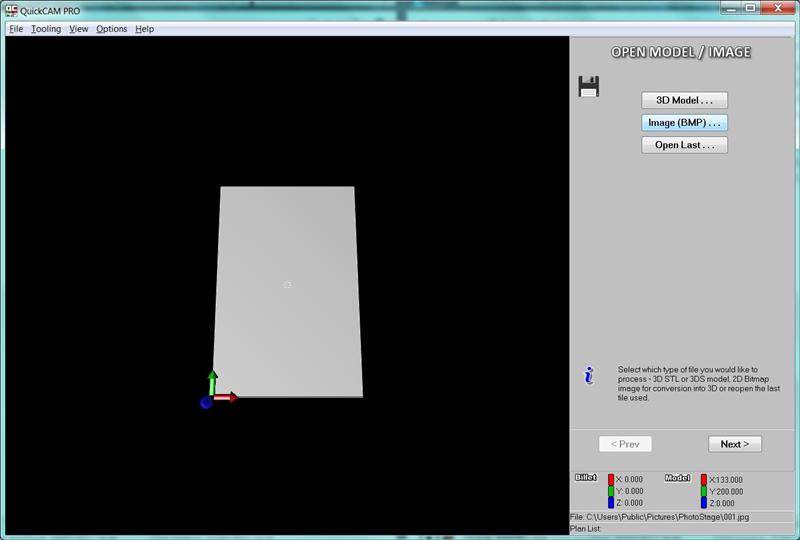

Instead of this...
Instead of this...
Then pick a better graphics card, or update your openGL driver!
