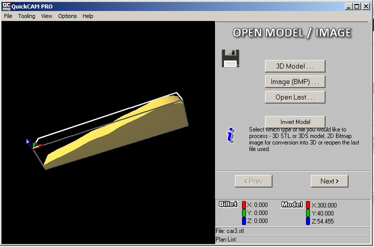

I have downloaded and opened in QuickCAM PRO without problem.
What was your problem?
car 3 .jpg (70.39 KiB) Viewed 40885 times
Re: STL problems
when we put this this through QuickCAM 4D a 'hole' appears in the base....please see attached screen shot
