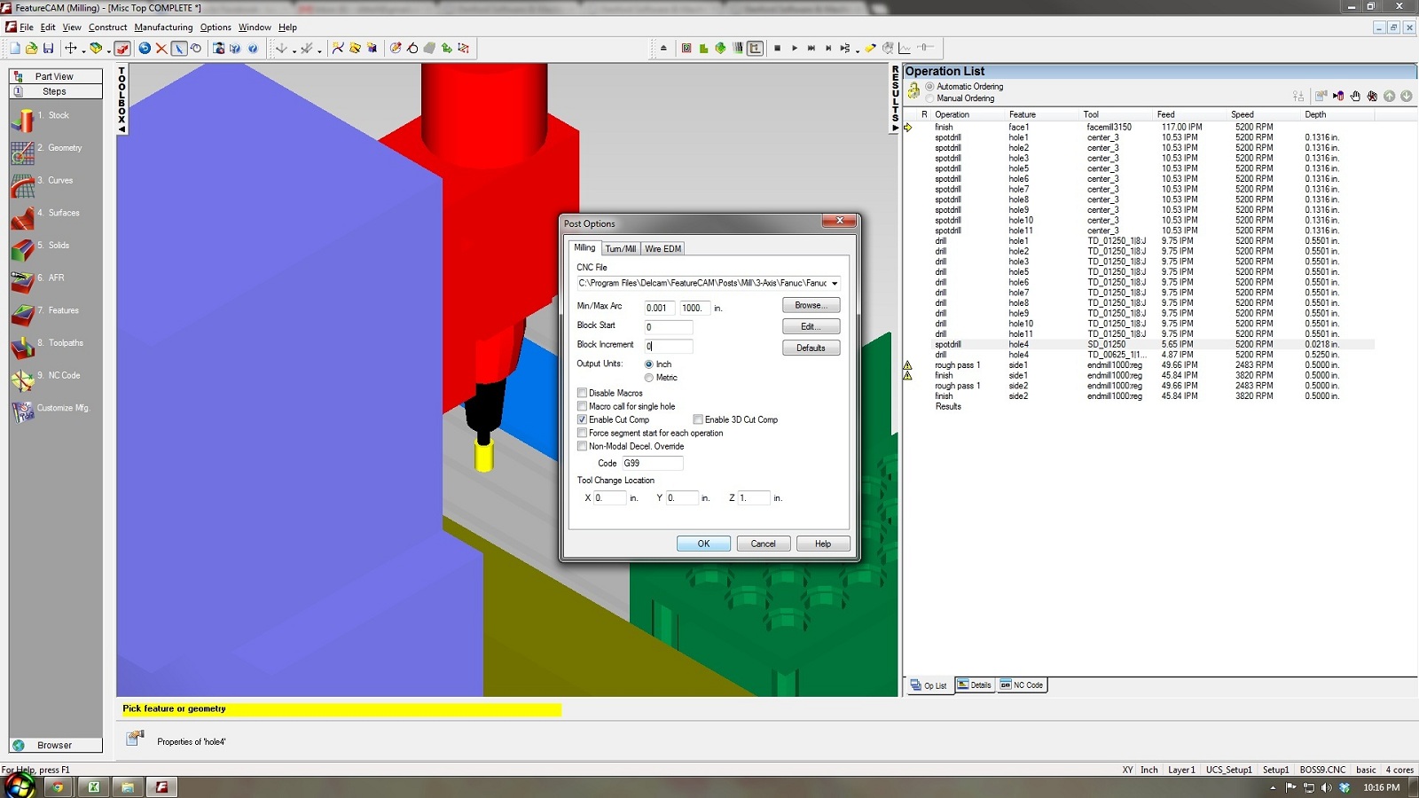

Hello my name is Zack. I am a student and our university has a denford novamill that no one has used in years. It has a denstep controller and the V2 milling software. I am wondering what post processor I can use to output gcode from featurecam to work in the VR milling software.
This should be possible am I correct? I see a lot of people doing conversions to mach3 as their control software what benefit does this have? Just the ability of a more attainable newer software?
I have tried the fanuc m0 post processor to no avail so I am wondering if anyone can help me out.
Example gcode using the Fanuc 0M post processor.
errors on 4 line because of too many codes on a single line
then every so often wants file 9099.fnc or 1011.fnc to be in the same folder and i have no clue what this file even is.
it also likes to complain about bad arc end points which i am just going to assume is because i have the settings in the screen shot wrong.

Screenshot of Post processor
For Forum.jpg (276.33 KiB) Viewed 8228 times

Some things to try:
1. Make sure the output is metric with 3 decimal places (eg 25.400)
2. Disable macros - this should get rid of the errors where it's looking for program 9099.fnc
3. Definately turn off cutter comp - let the CAM output compensate for cutter diameter as VR Milling 2 will more than likely not do it the same as intended.
If you are then only left with errors about too many g-codes, then you may have to live with that, just edit the program and insert a new line between the list of codes...
G00 G17 G40 G49 G80 G94
becomes:
G00 G17 G40
G49 G80 G94
