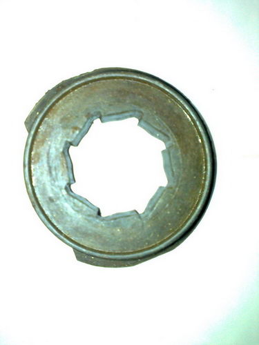

Some parts of it has worn, for example pic - parts inner diameter is now 1,5mm larger; rotary switch (ordered one already) and hooks or jaws (i don't know how to call them :) ). I think it rather needs to be replaced.

So, the parts:
TP126/3 - Worm gear
TP126/5 - Reversing Bush
TP126/8 - Locking Pawl
Last week I received and installed new Rotary Switch (Grayhill), now the machine functions a bit better. But I wish to replace all worn parts if possible.

One more:
TP126/9 - Locating Pawl

Sorry to say we dont stock any of the items but the Worm gear was made by Hewwitt & Topham
Royd Way, Keighley, West Yorkshire BD21 3LG United Kingdom Telephone: +44 (0) 1535 602587
I have attached drawings for all the parts. I am sure you can make your own on some of them but can subcontract the others.
