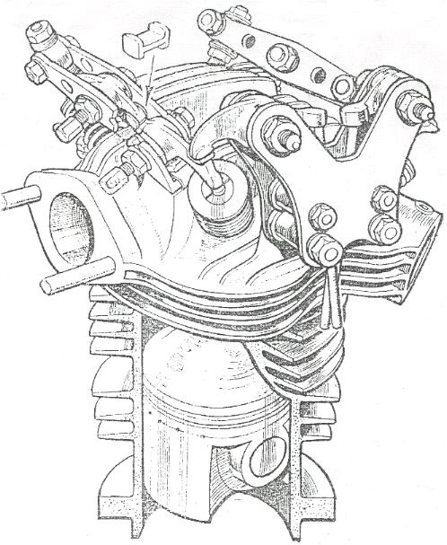

These are overhead rockers for a 1930's fully radial 250cc Rudge motorcycle.

Couple of pix to show how they work!

Material is EN36B (3 1/4% Nickel chrome, 65 ton) These will now be hardened .040" deep to 65 HRC, then the side bearing faces surface ground & the bores honed.
Cheers, Roy
