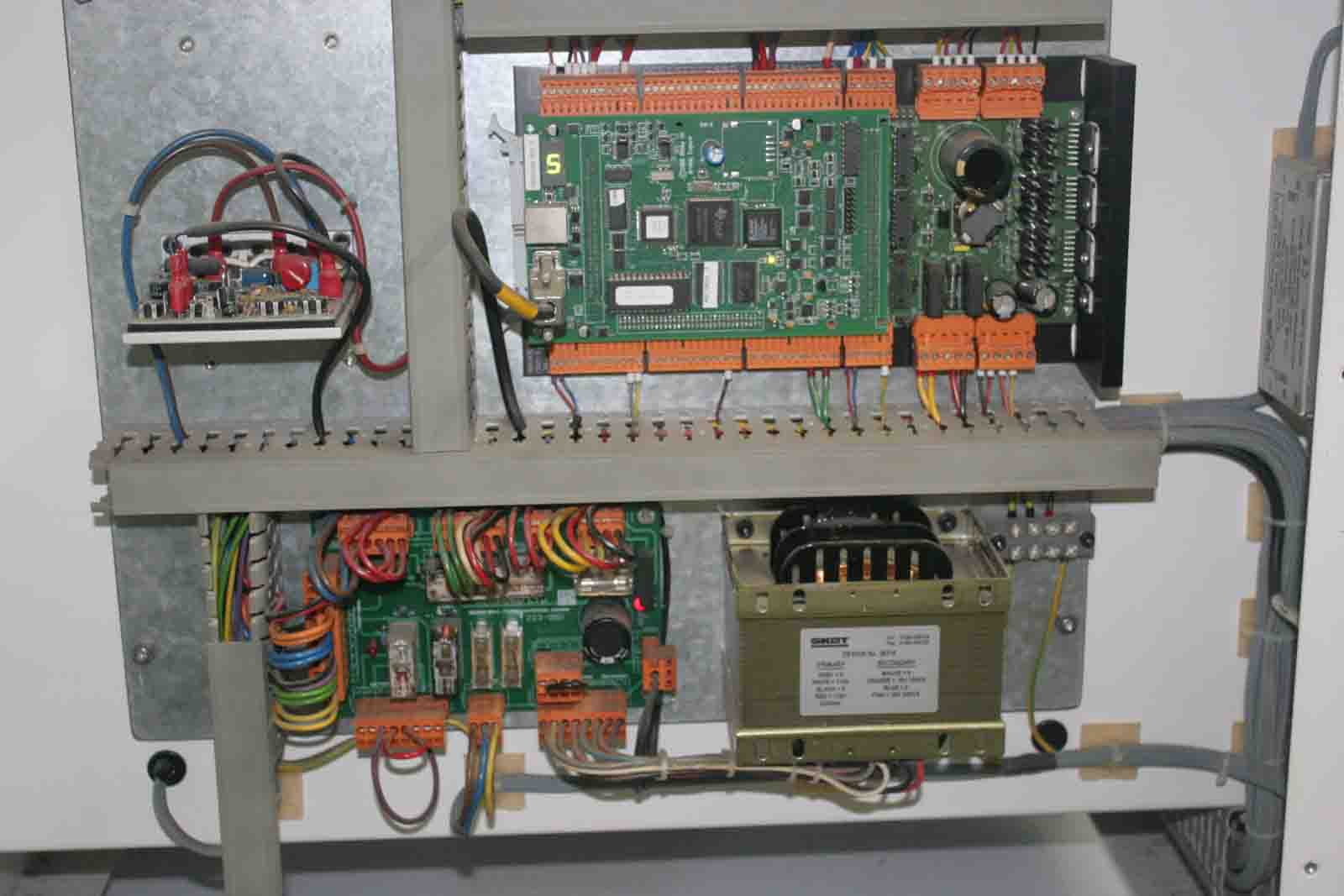

i am posting pictures of the circuit board.

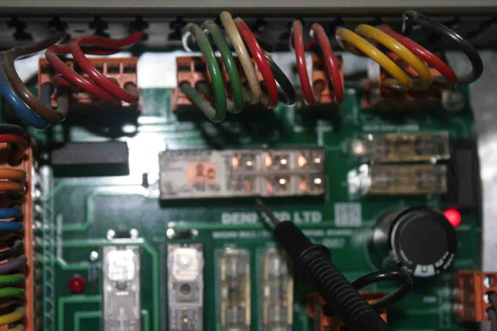

In the photo, i noticed that one contactor as pointed, is normally in contact or engaged. is this normal?

The relay you point out is the E-Stop relay. This should energise as you release the E-stop and drop out as you press the E-stop. Can you check if this happens?
I have highlighted the E-Stop circuit. The E-Stop will release provided the EStop is released (contact closed) and the reset key is also closed.
You can check this by dabbing a link wire from Pins 3 to pin 6 on Conn 6 This is shown in the diagram in red and will cause the E-stop relay to energise. If it drops out as the link is removed then the EStop contact is faulty.
Yopu can also check with a meter from pins 3 - 4 for continuity. There should be continuity when the E-Stop button is released.
I would try and vacuum the E-Stop contact block while pressing and releasing it.
