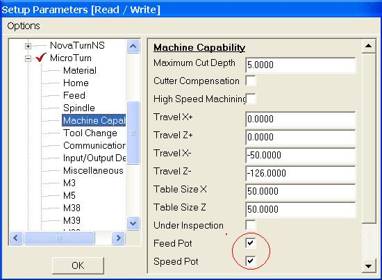

Speed and Feed Pot tick boxes
If your machine has Speed and Feed Pots and you have just reinstalled VR Milling and the pots don't work, the you may have to activate the pots manually.

Re: Speed and Feed Pot tick boxes
This has a good tutorial on selecting and configuring your machine in VR Milling (see the .pdf Selecting and configuring the machine):
viewtopic.php?f=2&t=2903
