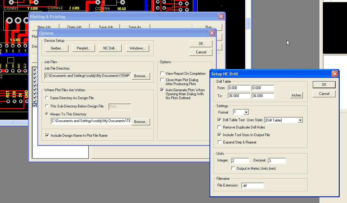

I use a package called Easy-PC which has various setup options For drilling I use the NC Drill settings in Excelon format. I attach the settings,

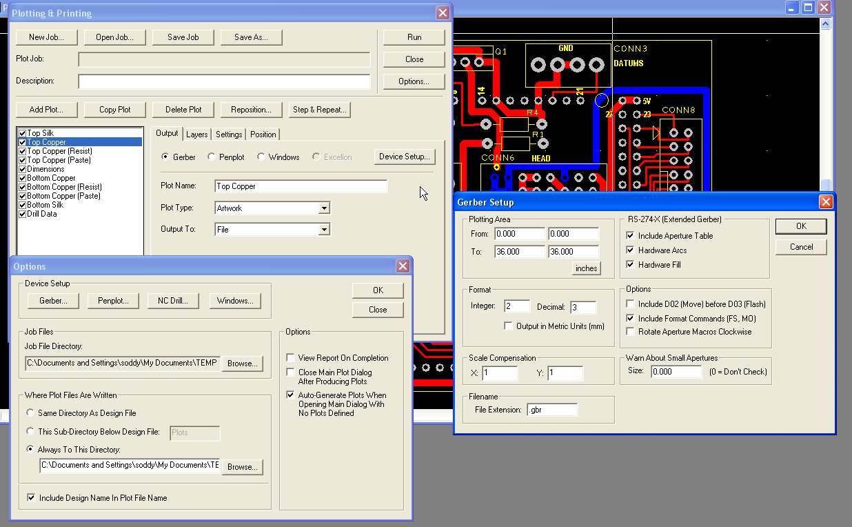

Gerber settings I use are as below.
Re: Seetrax Ranger2 XL Gerber import Problems
Note in both the Drill and Gerber setup windows there is a plotting limits setting in this case set to 36"
If this is not set then the tracks do not import,

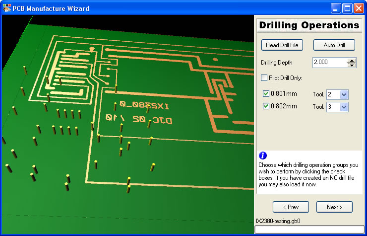

You may need to turn off Pilot drill only on this screen.
The autodrill looks for different size pad holes and assigns a tool number to each one.
In the .drl file I loaded here, tool 2 and 3 are called with an M06 near the end of the program.
