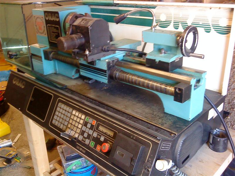

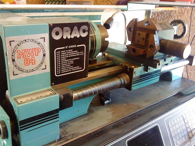

Ok managed to upload a few pics. As you can see the lathe is in great condition apart from the slight tear on the keyboard cover. Both screws and motors run very nicely.
O and it has an automatic tool changer which I believe are near impossible to find these days! I also have a regular quick tool post changer.
Since the pics have been taken out I have removed the electrical innards. I am planning to run the spindle motor off a 3 phase invertor (probably from ebay). I was thinking about making my own custom power supply or potentially buying one, depending on which works out to be cheaper. Stepper controller wise I'm looking to use the stepper controllers and uniport breakout board from zapp automation. Quick question, am I right in thinking that the steppers originally ran off 72V? Can't remember where I seen the figure but 72 rings a bell.
I'm planning on squeezing a PC in the space under the lathe, along with everything else. As am likely to be machining steels and titanium I will be installing a coolant pump. Flat screen monitor (touchscreen if i want to be really fancy) with mach 3 controlling the lot.
Another thing I was wondering is how the tool changer interfaced with the original electronics and how easy it's going to be to interface to mach 3?

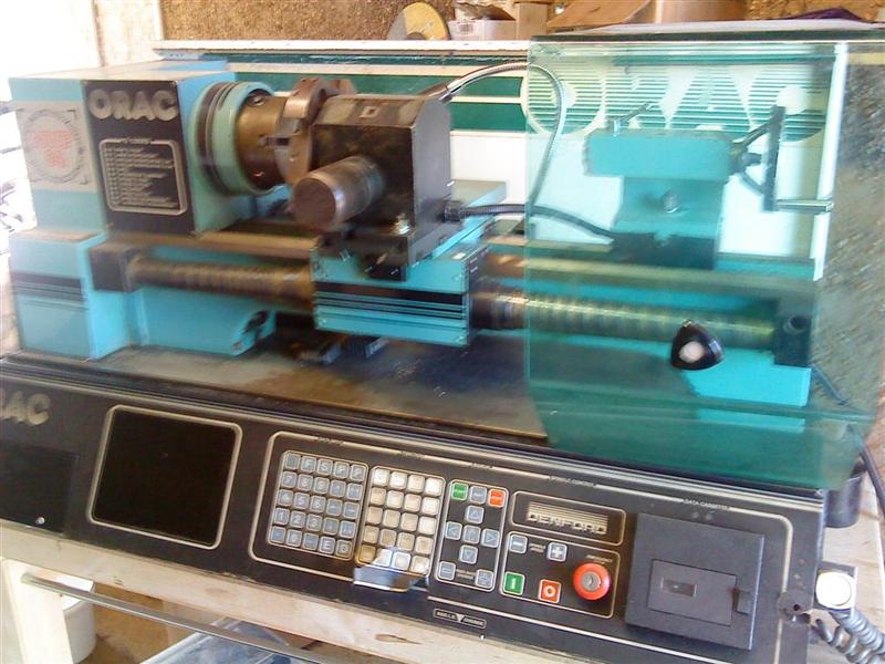

always fun to read about others projects.
Dont know if I posted pictures on my encloser before?
I am very happy with it and I dont want an open solution again.
Sorry for the bad quality on the pictures
