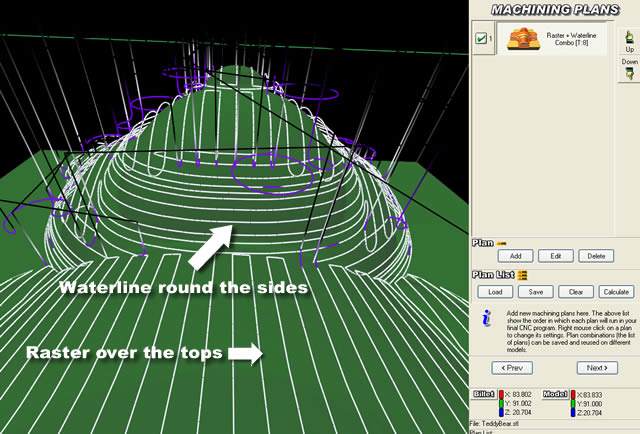

Alternatively, try the combined raster+waterline plan which raster over top surfaces, and waterlines around the steeper sides (see picture)
The Raster and Waterline Combo machining plan in QuickCAM Pro (not available in QuickCAM 3D)
