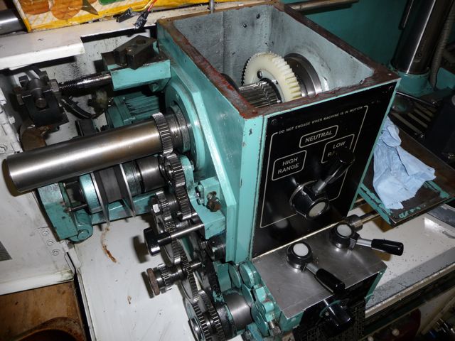

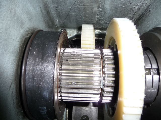

I have a Viceroy Lathe 280VS Synchro with mechanical speed control. It has sheared teeth on the 68T Nylon gear on the hollow headstock shaft. I have been doing some searching on this forum and note that I am not alone. A few people have made new gears out of Delrin/Acetal - something I am prepared to do using my mill and a friends's lathe!
However, I am seeking some advice on how I remove the gear. I am hoping not to have to disturb the double row tapered bearings in the chuck end and then have the problem of pre-loading them on reassembly. I was hoping that I could slide the shaft out from left to right without dismantling too much - or am I being too hopeful? In which case, how do I remove the internal belt drive and the other gubbins to get that nylon gear out?
Any pointers would be most welcome. Also, does anyone have a 12DP involute cutter (20 degree pressure angle) for loan or sale please.
I think(!) I have attached a couple of photos to aid clarity,

To remove that gear you have to pull the spindle out of the headstock - it comes out to the right and it's a devil to get out (or mine was).
