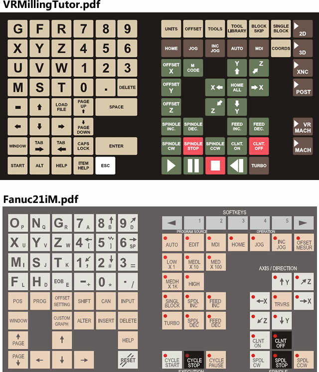

Its a bit confusing as there was a mix of old style Fanuc overlays which are the ones you have.
They were originally made for the DOS machines to look like a Fanuc-0T or 0M they were then made to work (sort of) on VR Milling and VR Turning.
The Turning layout you prefer was never made into a proper overlay - IIRC
The black and brown layouts were however, and I think these are what Bradders has still in stock...
There is also another style of overlay we had made to look similar to a Fanuc 21i control.
The following attachments are for milling versions and can be found on the VR Milling CD's (both version 2 and 5).
Fanuc21iM.pdf
(94.46 KiB) Downloaded 1313 times
VRMillingTutor.pdf
(85.44 KiB) Downloaded 1279 times
