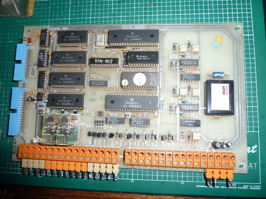

This is the board from the Starturn.
The owner would rather keep it than just give it away so make a decent offer if you're interested...
GSM Syntel slave board from a Starurn 8

Hi to Adm,
Thanks for all of your efforts. I will pass on the Starturn 8 board. (I will still take any leads on an LCB3 board). I have decided to convert my Starturn 4 to run Mach3.
