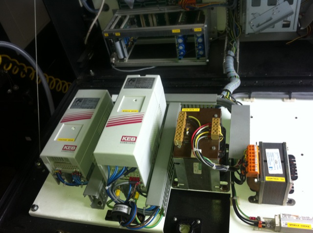

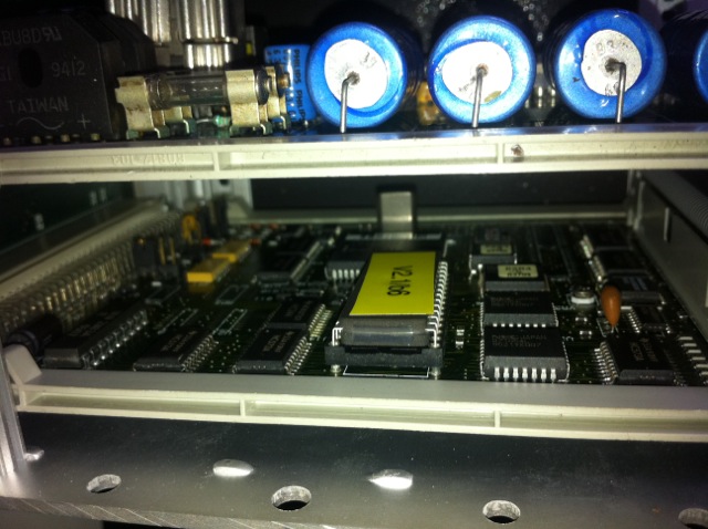

Can you post a photo of the inside of the cabinet and especially the Baldor which is shown in the top document here:

Attached 5 pics of the internals...

Check fuse F5 (Top left hand corner) & for 240volts ac on wires N & 4 going in to the spindle drive. I think that you should see a red led on the drive if it is powered up. Compare it with the spindle drive to check.
