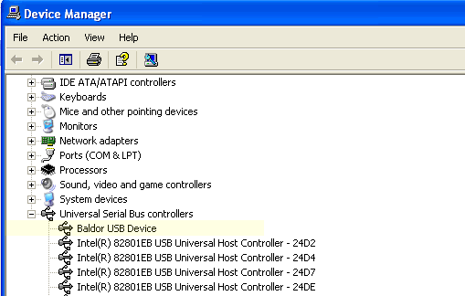

The access violation you are seeing is occuring because the machine is not connected / could not be found via USB or RS232.
It normally indicates that :
You are trying to run it on windows 98/95 - the USB interface is NOT supported by these operating systems (use RS232 in this case)
The Baldor USB driver has not been loaded correctly - check in windows Device Manager under USB devices (see atached picture) - if there is a problem, the USB drivers can be found on the original VR Milling CD under the \USB folder

The Baldor controller listed under USB devices (XP/2000 only)
