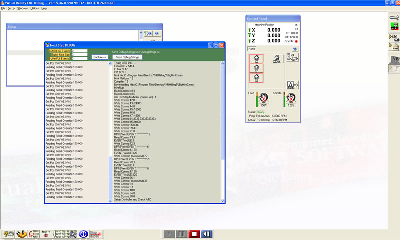

Re: Debugging connection problems in v5 milling
fyi the debug screen looks like this:
