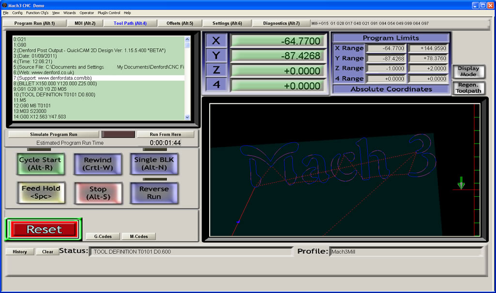

As you can see, the simulation in the demo version of Mach3 appears to work, but it's never been tested on a machine.
(the example in the screenshot was created in QuickCAM 2D Design and a follow toolpath created)
