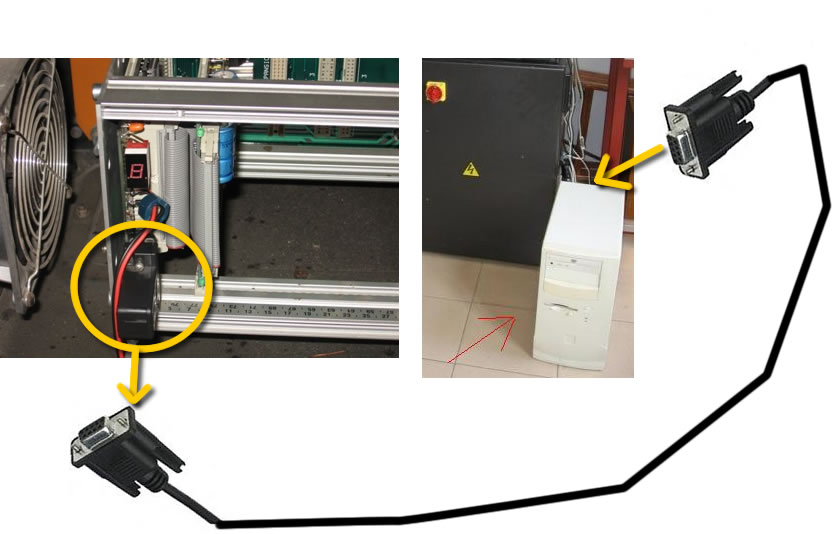

Just to clarify where the above cable should plug from and to...
